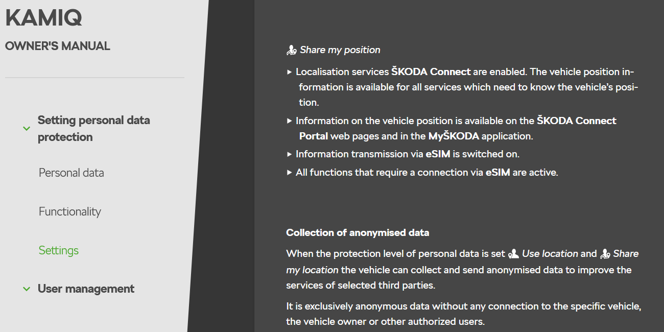

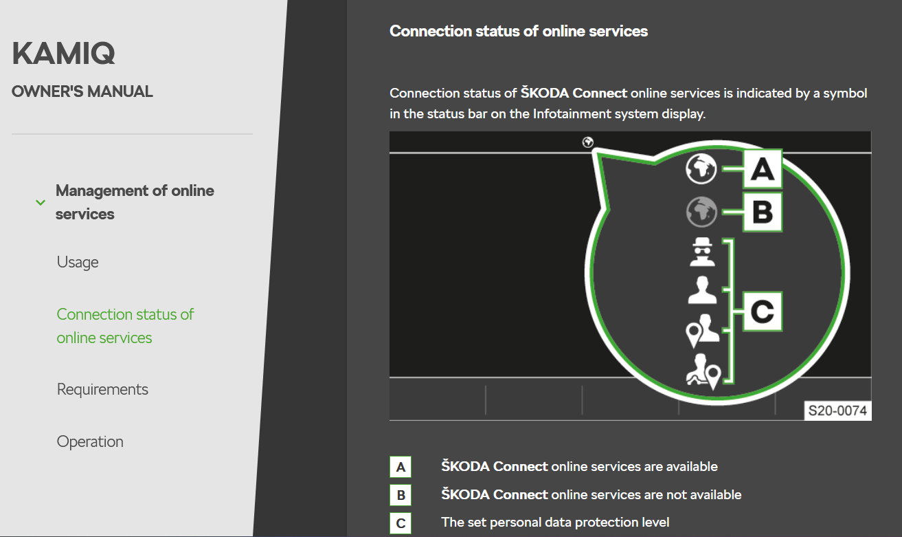

    Start by using the https://manual.skoda-auto.com/004/en-com/Models and either input VIN, or put in model year etc for your car. Then using the left side menu, locate the following... Online Services Setting personal data protection Scroll down on right side to near bottom Then using the left side menu, locate the following... Online Services Management of online services Connection status of online services
