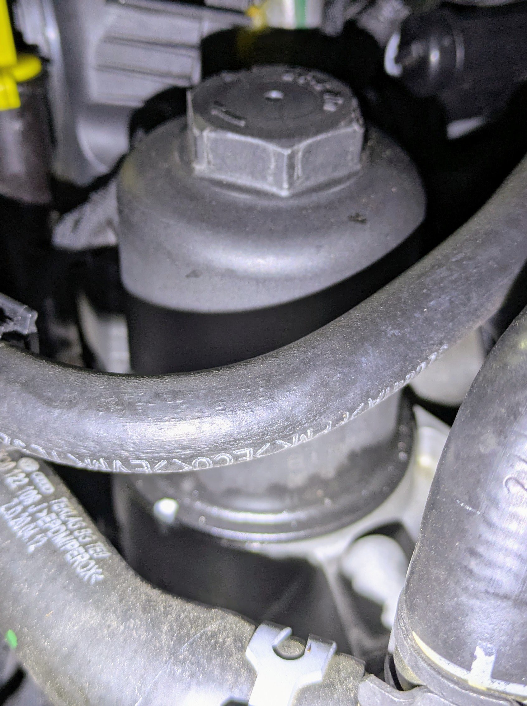

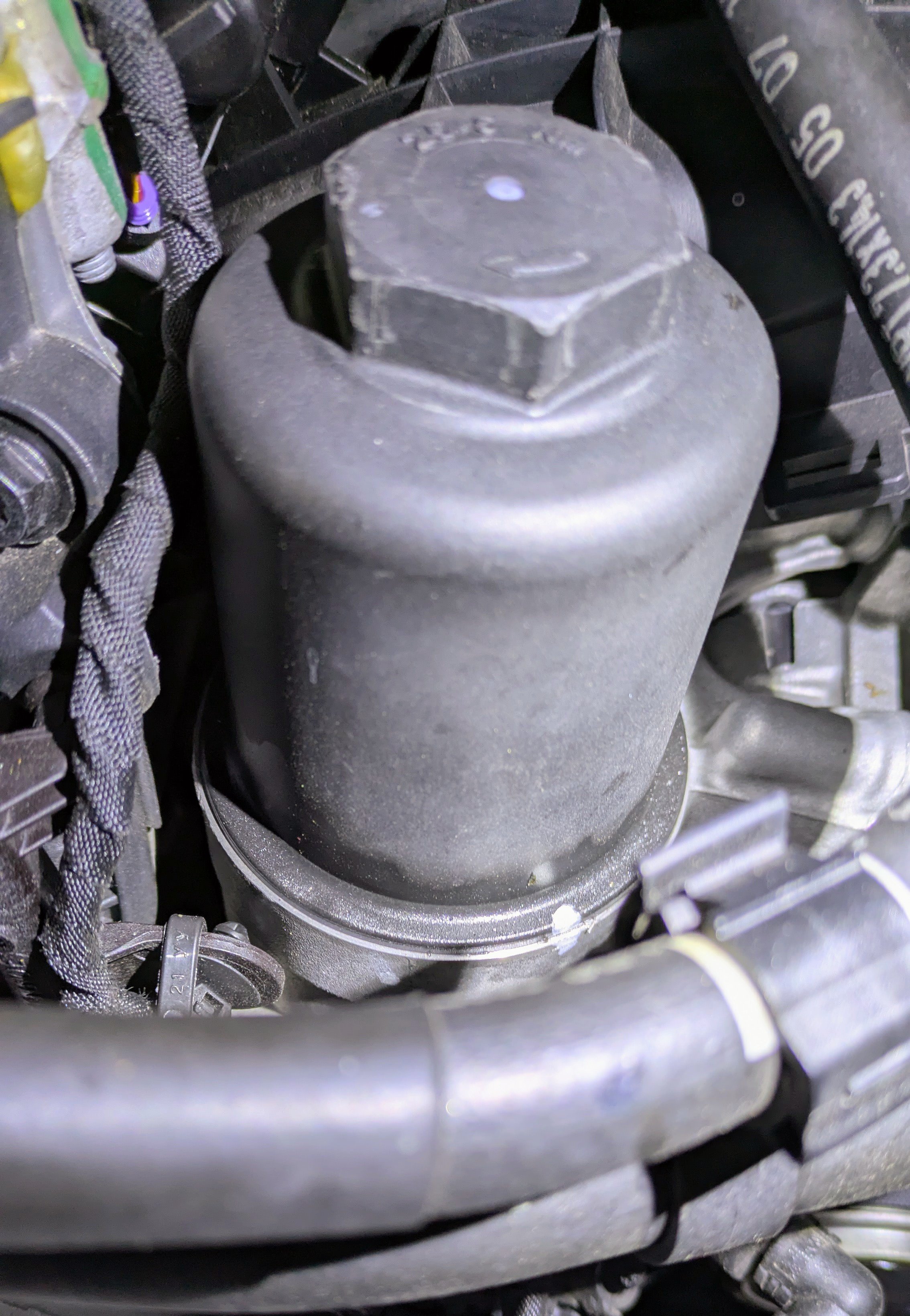

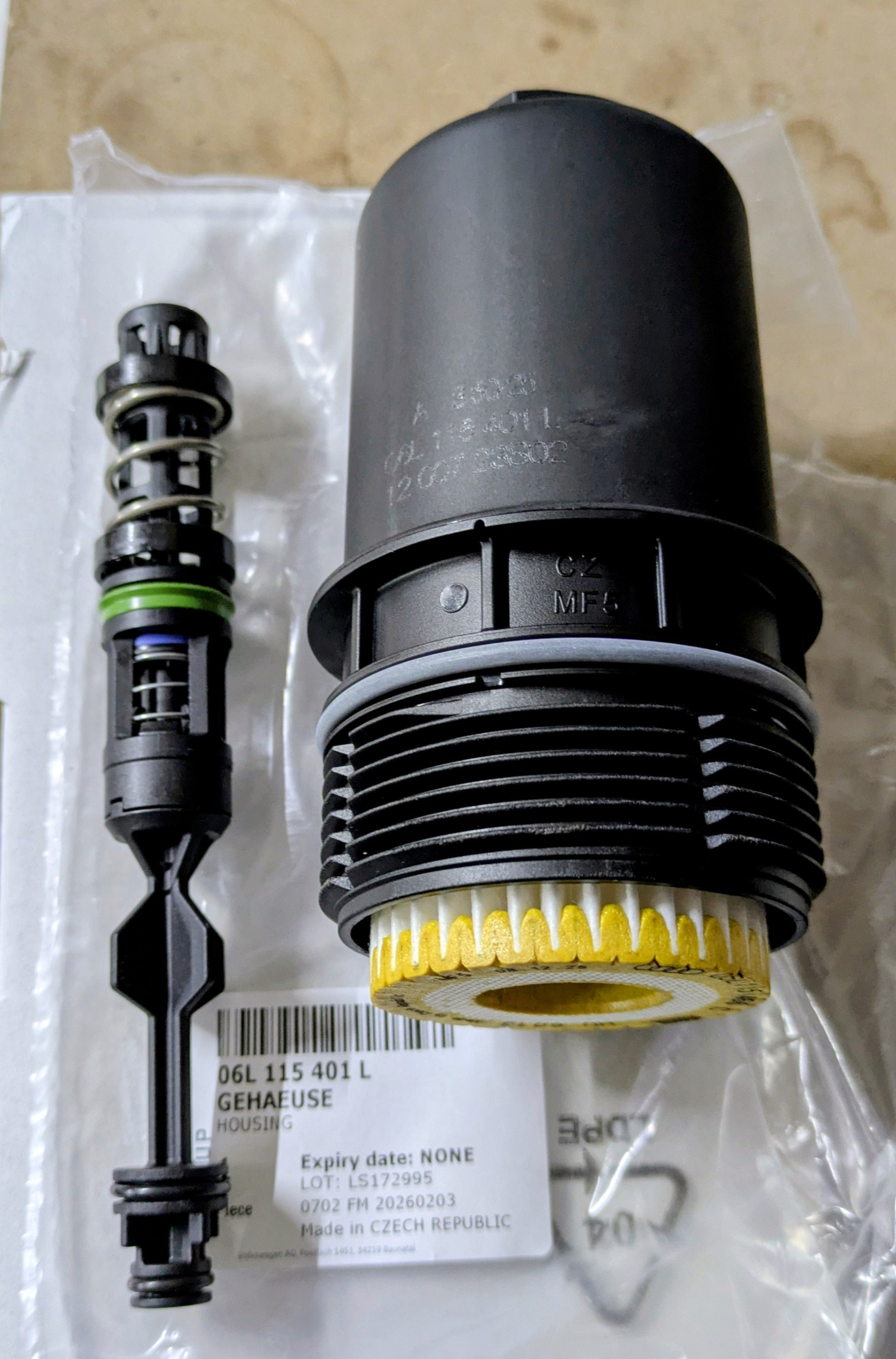

  2. So after 9 yrs, my oil filter housing started to show signs of an oil leak, all around the base of it. Gandalf wasn't loosing any oil though, based on the dipstick levels. Suspects include cracked oil filter housing, however the weeping was consistent all round it; or the oil filter internal valve adaptor, which the old versions r known to fail. The part has since been revised. or cracked oil filter housing O-ring. Based on that, I decided to replace the internal valve filter and oil filter housing. Parts:- Oil Filter Housing - 06L115401L Updated version, comes with oil filter and O-ring. Oil Filter valve - 06L115678Q Revised and updated version. Whilst I was at it, I also replaced the oil cap. Time to monito now and see if there r any new signs of oil weeping or misting. Fingers crossed.
