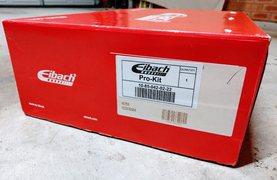

Lowering springs help please
This topic has been covered many times. Given u have the 280 AWD, part number u want is either:- E10-79-012-04-22 for wagon/estate (3V5) E10-85-042-03-22 for sedan/saloon (3V3)
