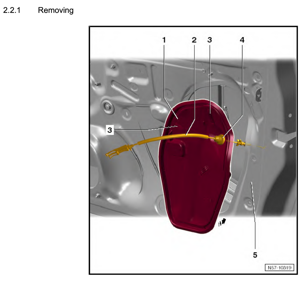

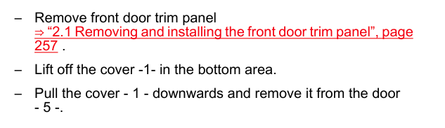

  7. Yes. Apart from pressing in the sides of the box to disengage the tags, you need to disengage the damping arm - here called the compartment brake element. It's about the size of a pen and is only fitted to one side. For your left hand drive Octavia I suspect it is on the left side.
