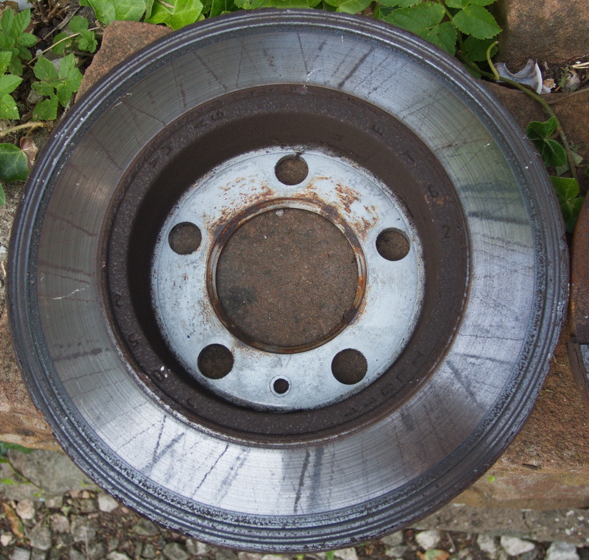

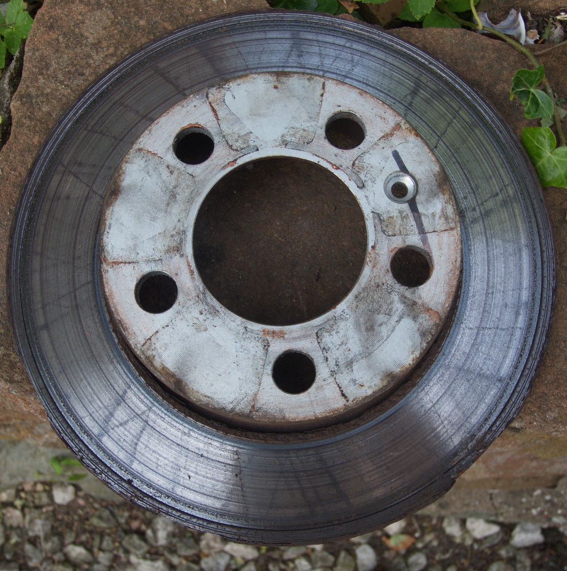

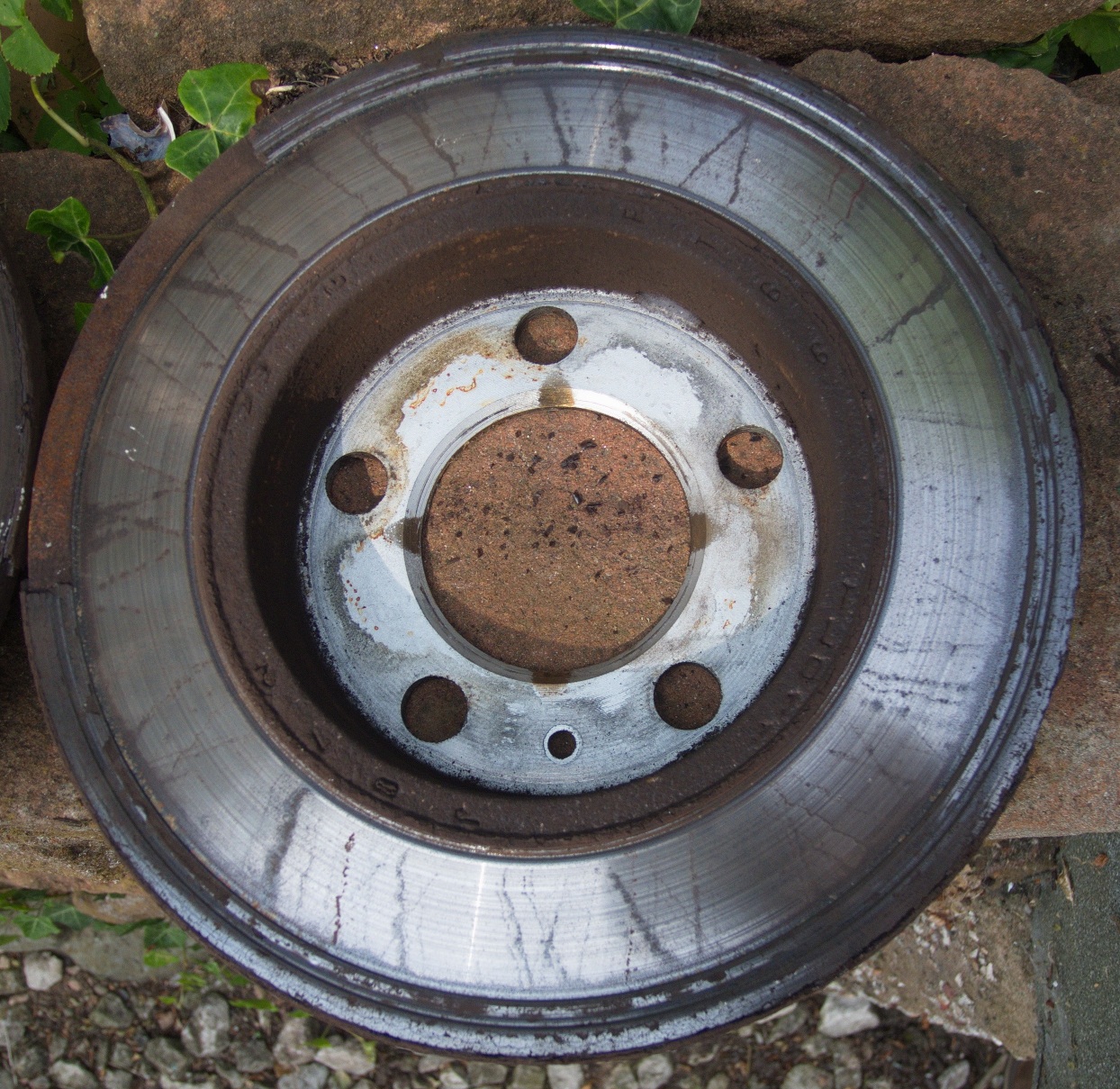

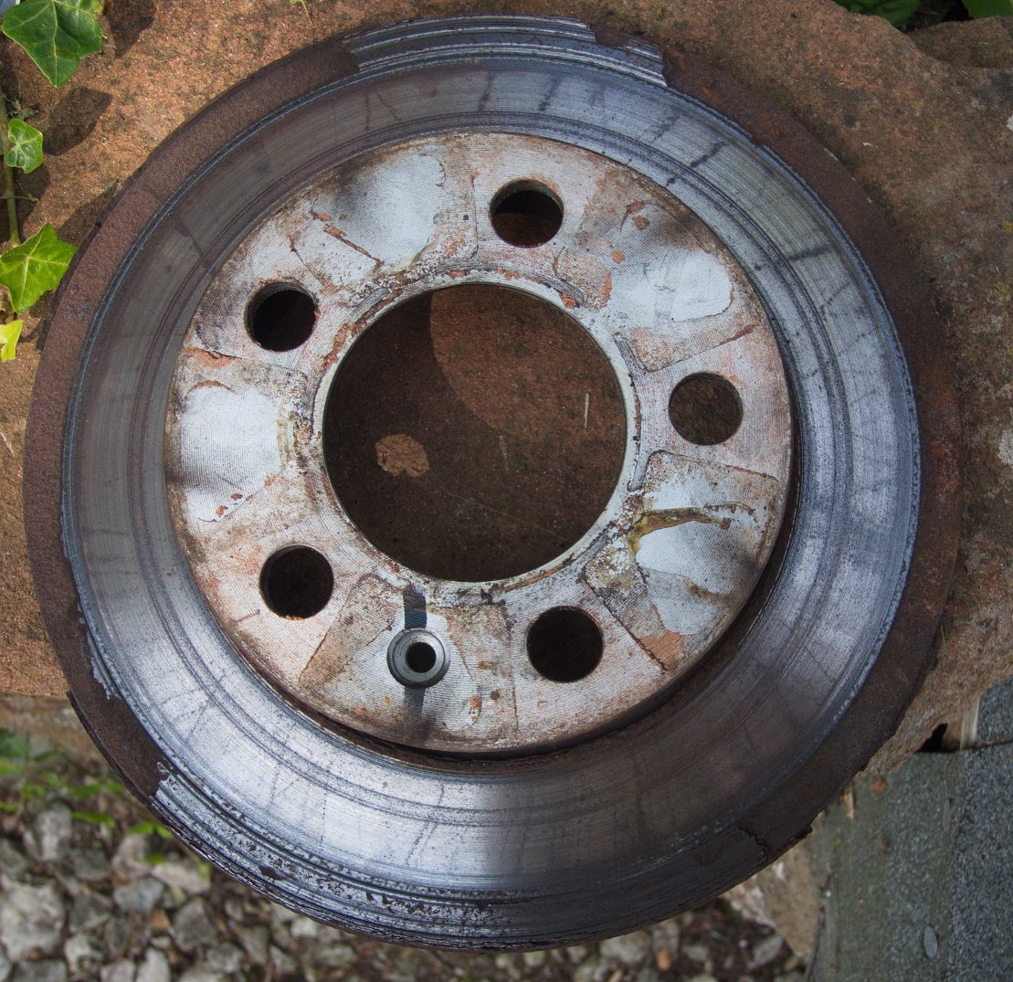

I have now changed four sets of rear discs on four Skodas before the first MoT over the last ten years. One one I heard chunks of the disc surface delaminating and hitting the wheel as I drove. Truly awful quality and quickly replaced by me with components from a known brand. Anyone who fits these as OEM parts needs their head examined. The truth is probably that Skoda/VAG use a range of suppliers, all driven down to the lowest possible price - so you might be lucky. The picture shows a Rapid rear disc at 15K miles / 2.5 years. Didn't bother Skoda with a warranty claim since I knew I would be fobbed off. £35 and an hours work sorted it. Now - 10K miles and a year later - not a sign of anything happening to the rear discs.- Odd sound from brakes
