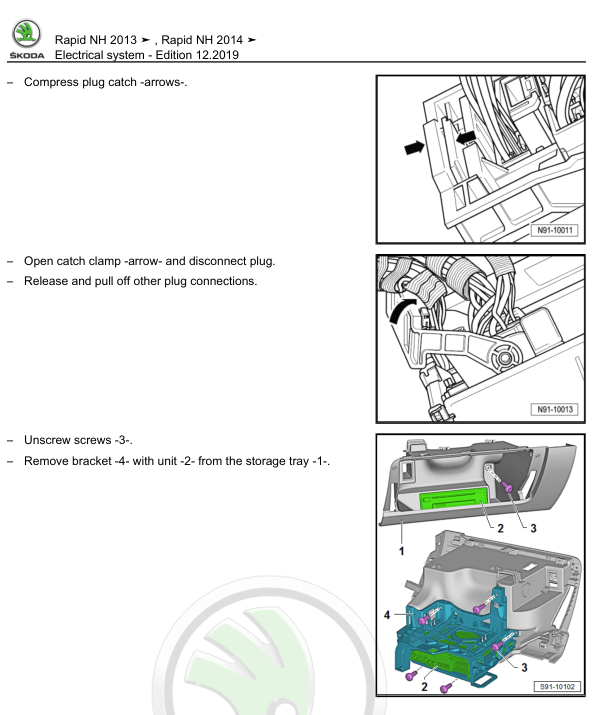

  7. Looks like you need to start with the two clips at the rear. Then keep working along to disengage the two big clips halfway along the side. Then withdraw the unit to the rear after disengaging those two long prongs at the front.

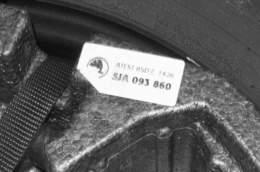

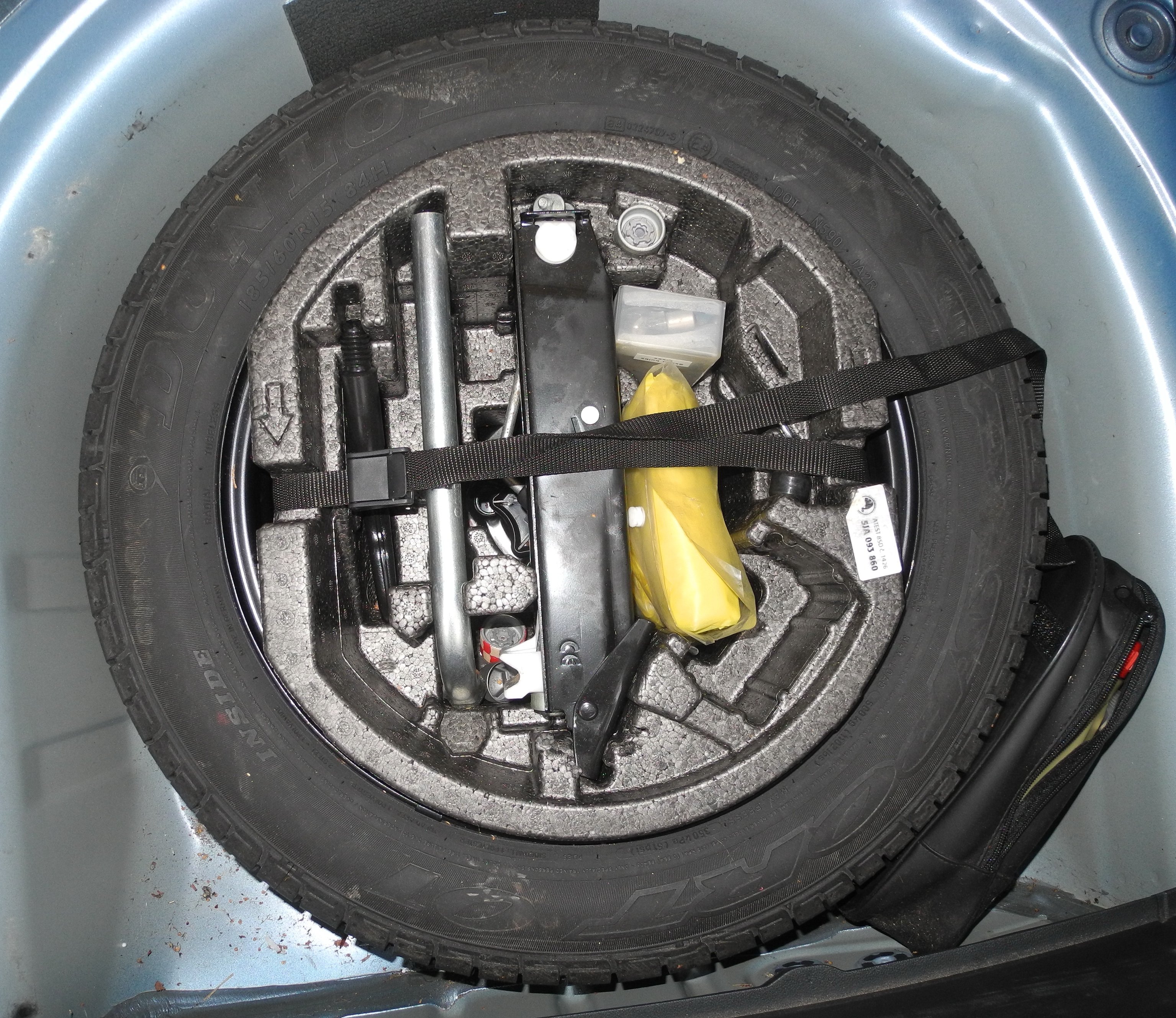

  20. This is my wife's spare with the tool insert in; tyre size happens to be 185/60 R15. Wheel might be a 6Jx15 ET38 but you'd have to check.

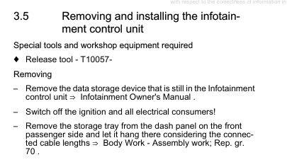

  23. Upgrading software of the infotainment unit is unlikely to help. Others have fixed this by replacing the SOS module or upgrading the SOS module firmware. Your dealer will have had plenty of experience fixing this fault......
