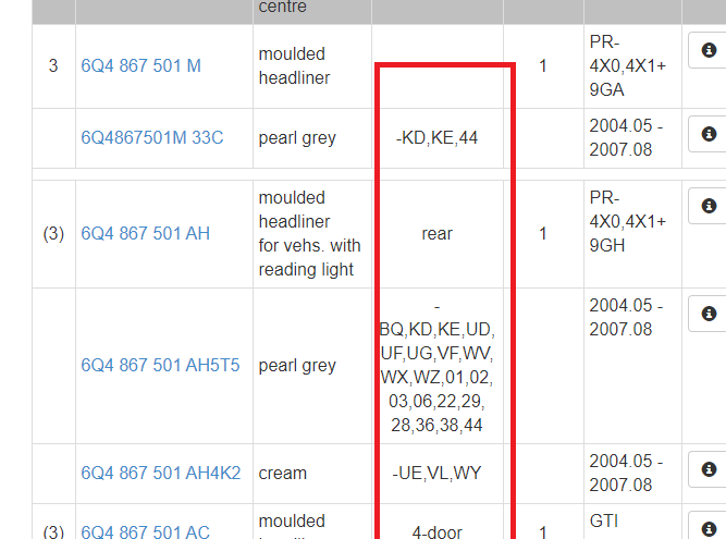

And now a question about ETKA that I would like to understand, if anyone knows? In this screenshot of roof lining part numbers (for a 9N3 Polo but I don't think that's relevant) there are a bunch of two-letter codes, and some two digit numbers. In the same column as more readily understood terms like 'rear' and '4-door'. Anyone know what the two-character codes are referring to?
