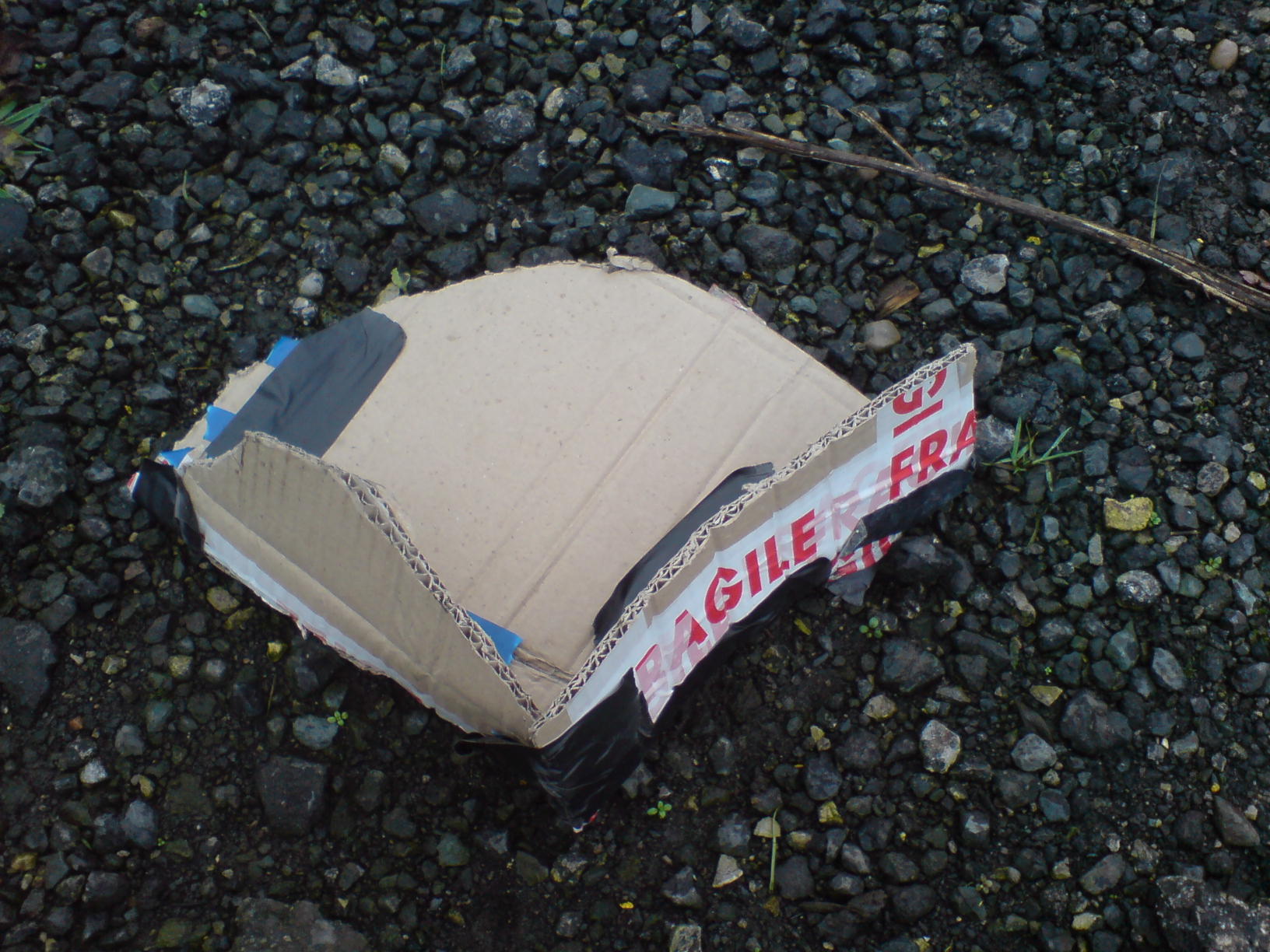

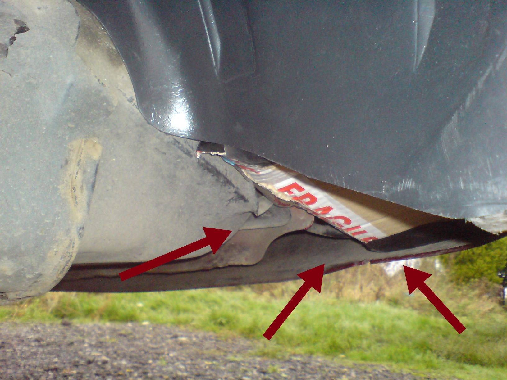

  9. I've found some liquid latex, that I should be able to brush on to my template to make a new undertray to fit the gap. Although I'm not sure about the strength or flexibility of latex.

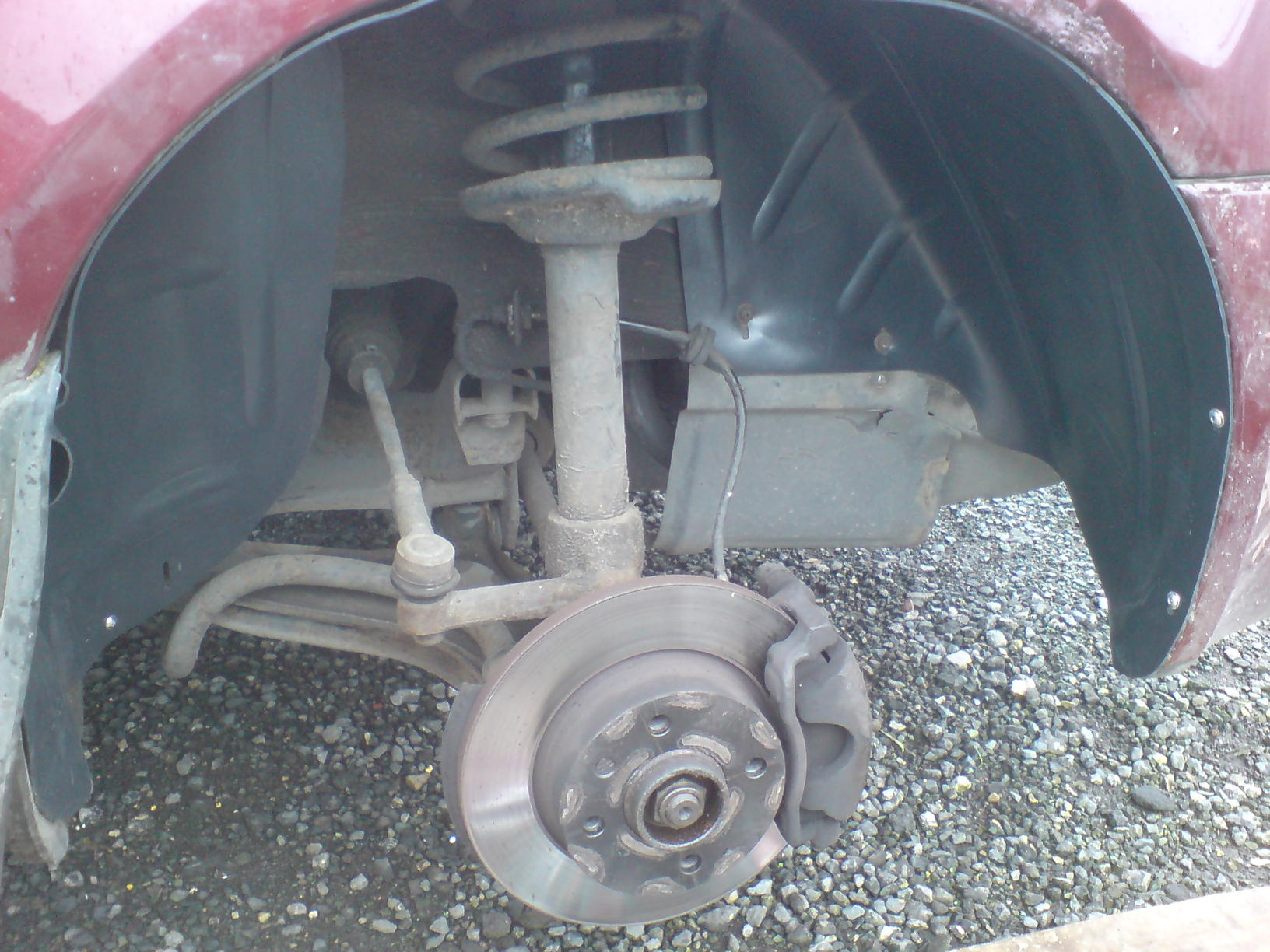

  10. To me it looks like it's half finished. On most modern cars this bit is also covered by the undertray. I been thinking maybe trying fiberglass
  11. I've fitted this aftermarket wheel arch liner, and I'm somewhat happy with it. But I don't like this gap that it leaves behind the fog lamp. I've knocked up this very rough template to fill this gap. But I need some advice on how to make this in a harder material, preferably in flexible plastic. I don't know if there is something out there that I can dissect to make fit, or whether I will have to manufacture it somehow myself.
