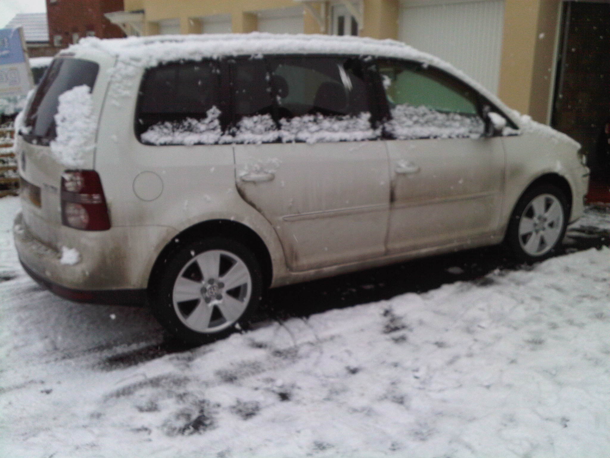

I put the wheels and tyres I purchased to put on my octavia when it arrives on the touran yesterday. They are fitted with 225/45R17 vredestein wintrac xtreme tyres. I have found them wonderfull. Did 120 miles last night in the snow. Only complaint i have is found my self doing 65 mph on the motorway then notice there were lots of snow covered signs. Then I rembered that I must be in 50mph average speed zone.
Plus i think she looks nice on them. locks clean now the snow has washed it to.
