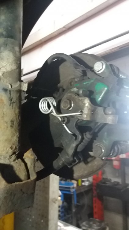

Hi all - Sorry for the problems I seem to have caused!!:(
Ultra_joel88 I have the same springs as you . A hook at one end and a kind of dog leg at the other? I currently have the O/S spring with the 'dog leg' fitted to the handbrake lever part and the 'hook' fitted into the fixed bracket bolted to the caliper still with the 'coil' of the spring towards the rear. In this position the offset of the 2 arms of the spring matches the offset between the lever and the bracket so the spring sits squarely.
I do take ric04vrs' point that fitted as I have them the springs are somewhat 'exposed' but because the springs are always under tension I don't think they could be dislodged very easily.
I too think ric04vrs' springs may be different as they seem to have 'hooks' at both ends.
I fitted mine in the position I did after referring to the VAGCAT illustration which seems to show the 'coil' facing rearwards AND using the part numbers i.e. 1K0615295 to the N/S and 1K0615296 to the O/S. There only appeared to be one way they would fit!! :confused:
In your picture from yesterday your spring looks to be as close as you will get to matching ric04vrs' position - I've looked again at his images and his springs ARE different. Look at FAST-FITZ's picture - your springs and his (and mine) are the same!!
I hope you can get yours functioning again.

Have just put the return springs on my 05 Fabia vRS:-
1.Reverse up nearest convenient dropped kerb, to give yourself a bit more room under car without resorting to jack out and wheels off.
2.Fit flat end of spring into moving handbrake arm - see photo 9058 - the end of the spring locates nicely into the small round hole (once the hook end is properly engaged after stage 6 below)
3.By hand pull the hook end round until it catches on the bottom edge of the damper mounting/radius arm.
4.Using special tool A (photo 9057) - actually old back boiler poker with bent end - hook the end of the return spring and pull it round to drop partly into the L shaped slot on the fixed bracket. Needs a bit of a heave but with the long poker you can control it well and it doesn't spring out. Then you have to get the end of special tool A out.
5.Hold the spring in place with the end of special tool B (photo 9057) - actually piece of 20 mm square section wood or whatever's similar laying around handy, assisted by partner who doesn't mind getting down on the road with you in the 'spoons' position (obviously more fun if partner is opposite gender!)
6.Slowly ease the special tool A out of the spring hook end and as long as you maintain pressure with special tool B the spring pops into place without mangling fingers or chipping teeth.
Took about 15 minutes including finding 'special tools', shunting car about and press ganging assistant.
Hopefully someone else can make use of this bit of good old British ingenuity!

Hi rum4mo
Thanks for the headsup regarding the fitting of the springs - I've checked mine today and they are clear of the hanbrake actuator rod seal you mention. These seals are to minimise the ingress of moisture (which they don't do!) and within the caliper there is a further seal that prevents any leakage of brake fluid. I have previously pulled the seal you mention away from the caliper to lubricate the mechanism with no adverse effects.
If necessary it would take little to snip a small amount off the dog-leg end of the spring if this was a concern.
I did promise 53fabiavrs further pictures and attach them below.
It's good that there has been much discussion about this 'problem' and I think the general concensus is that there ARE better springs than the 1K0 type (fitted to VW Tourans with LUCAS rear calipers -PR-1KF).Fabia vRS have LUCAS PR-1KP! It IS neater to have the spring coil fitted to the front - all this would take is to swap the 1K0 springs over O/S to N/S etc.and turn them upside down before fitting.
While mine are working OK with no added 'weight' to the handbrake I'll leave them as they are. Everyone must make their own mind up whether this suits them or not!!
Kind Regards
Alan

Greybeard I think you've 'cracked it'!!.:thumbup:
The photos Nos. 3 and 4 showing the end of the 'dog-legged' end of the spring poking nicely out of the hole in the handbrake lever arm - as though it was 'meant' to be - would now suggest to me that this IS the way to fit the springs!!
I would also compliment you on your ingenious fitting tool!! :rofl:
Kind regards
Alan

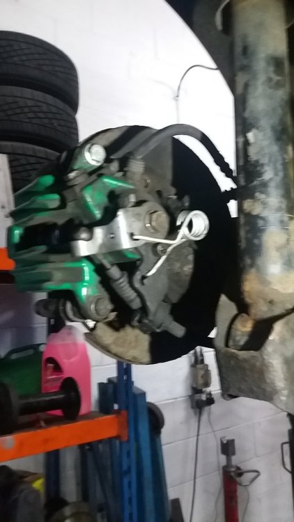

Thanks Alan.
For those who may want to see an indication of the tools in use here's a couple more photo's.
Also worth mentioning that if you fit them with the handbrake off the distance to bend through is shorter, not much difference but every little helps when heaving away under the car with not much room to work.
No I wasn't going to take the springs off again to show it all in real time...... in any case there isn't enough room under there for a photographer as well!!

Okay, so I now have the Sharan springs - ie 7M0 615 296 and 295 - they are a lot smaller than the Passat B5 8E0 springs so I'd say don't buy the 8E0 ones, BTW the Sharan springs are 1.54 each + VAT. Here are a couple of pictures comparing the 8E0 springs and the 7M0 springs:-
30877.attach
30878.attach
One thing to look at is that the Sharan O/S - ie 296 spring is the opposite of the Passat B5 O/S - ie 296 A - from that I think that we can make the assuption that these springs should be fitted with the coil towards the front of the car - which I think is the way ric04vrs fitted his Galaxy springs, which incidently are also the opposite "hand" to the Passat ones - so either both ric04vrs and I have been given the wrong p/n or part for O/S and N/S, or what I've suggested about them needing to be fitted coil towards the front is sort of belivable. I've not swopped the springs over yet, but one thing that I'll also need to do is slacken off the cable slightly now that the levers always end up on the stops as I've noticed tonight that there is a slight "mooing" when moving off that can only be getting caused by a slightly "over tight" cable as everything else is new (pads and discs).
