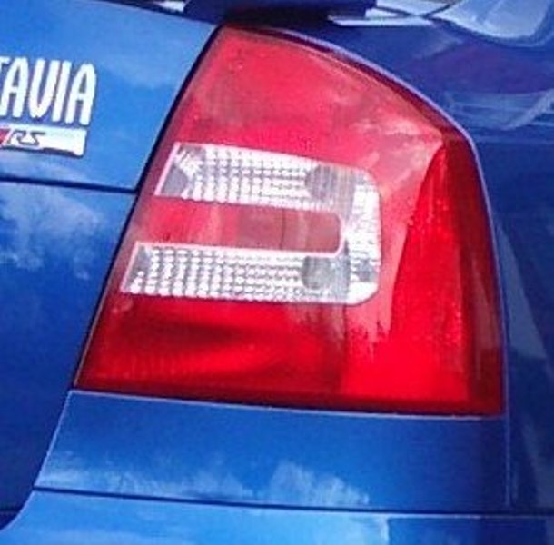

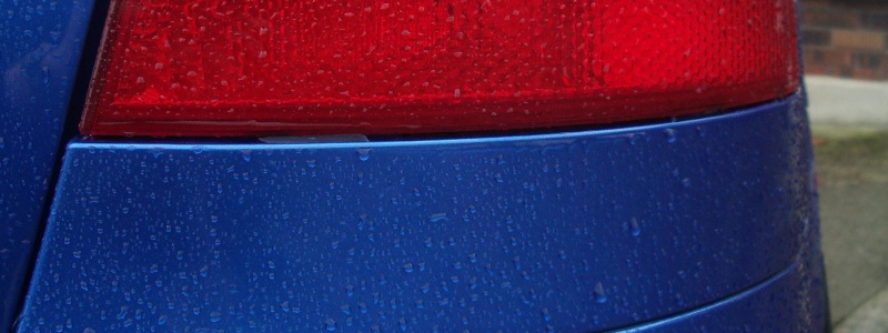

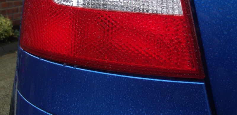

Garage had my bumper off before, after refitting the gaps between the rear light and panel directly under were massive. It definitely wasn't like that beforehand. We checked other brand new ones in the forecourt and they were exactly the same....sh!t.
Took it home and went at it myself, popped out the panel under the lights, loosened bolts and realigned, then put back on panel......took a couple of go's as hard to align without the panel in position. Eventually got it perfect.
From yours it looks like the bumper it up too high pushing out the panel at the top. My initail thoughts would be that your bumper was off, but I have seen brand new ones sitting in showroom worse than yours
See attached photos showing mine when new (1st picture) then after damaged had been put back on with gaps ( 2nd & 3rd photos). It's much better now, there is room to move it.
