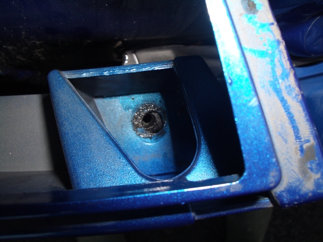

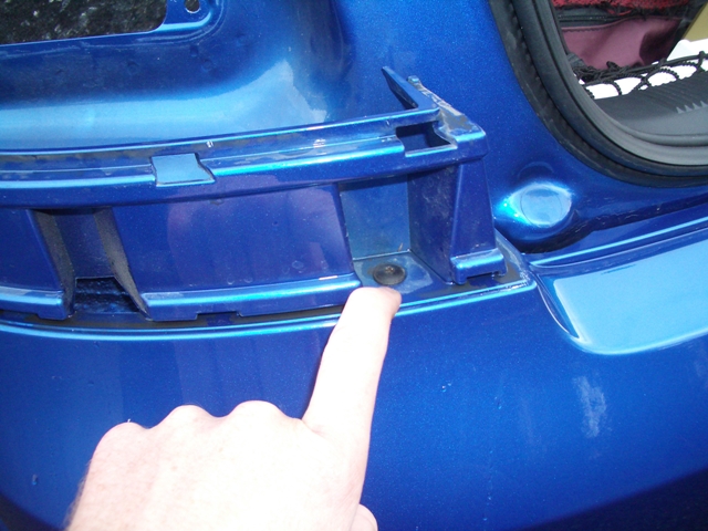

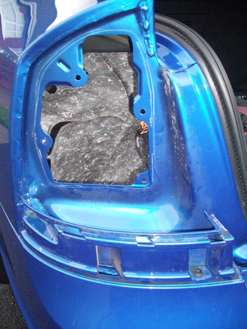

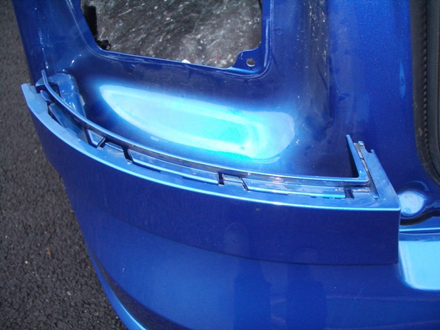

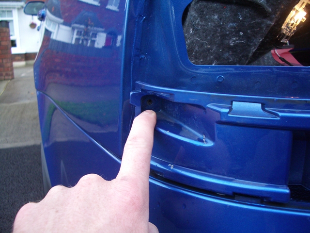

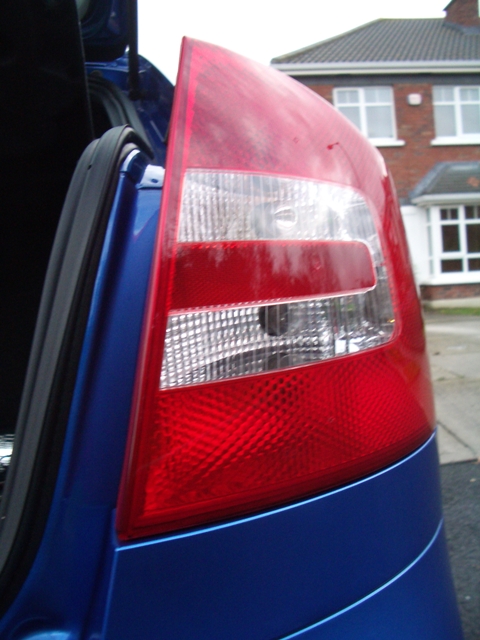

Once the cluster and panel are out, how is the alignment of the panel altered?

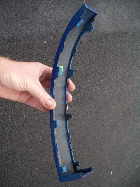

Seeing as I had my car prior to the bumper being off I was 150% sure that it was better prior to being removed, so figured something had shifted.
The bumper is held on by 2 screws each side iirc, so have some movement due to holes not EXACT size so there's some play. When I removed the light & Panel I could see the position of the original location due to marks of screw heads. The Photos I have clearly show that head was put into a different position. They also show there's some vertical movement with 1 screw and horizontal with other. You could probably get at the screw in Photo 4 without Panel removal.
I forgot I had these so hopefully will explain to others and to help wega3k.
You should be able to find a snug fit with loosening the screws and trying different setting.
