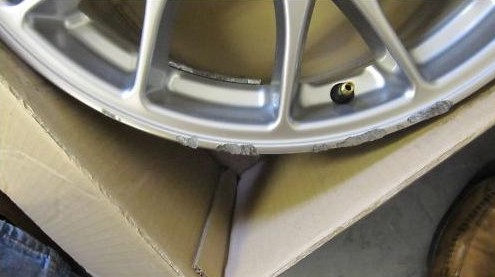

What makes me laugh in the ebay ad though is the fact the bloke describes the damage as 'wheel rash' - to my mind that's been absolutely tw-@-tted
I know! It's taken a right smack. Needless to say that picture was reference only
