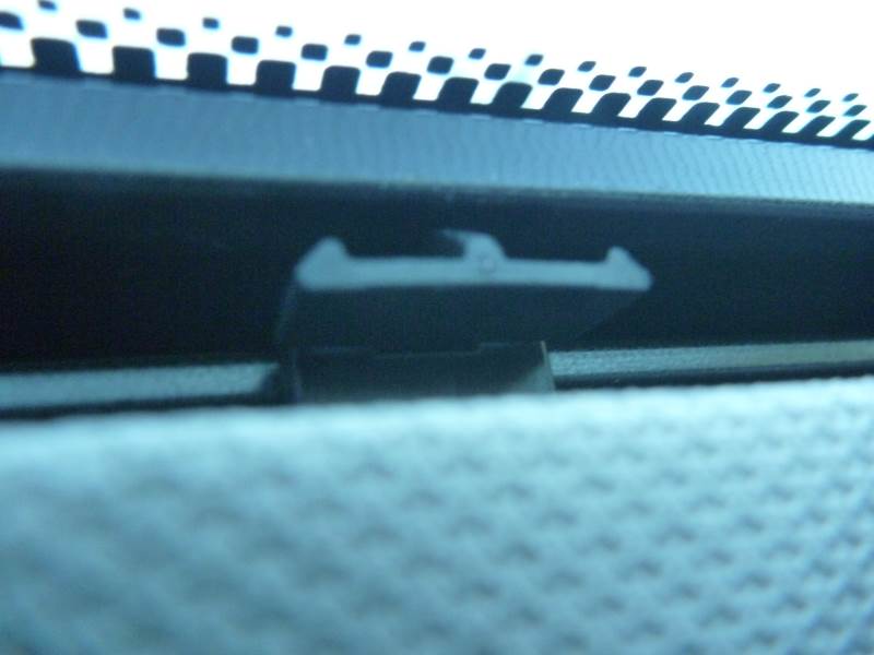

So my new (built June 2013) Roomster SE has this problem - the sunroof blinds will open when driving along. Obviously I'll get this fixed under the warranty, but I'm surprised this problem still exists & that they haven't added the magnetic catch or something similar as standard (or maybe they have & it got missed on my car).
I took a picture of the catch that's in the blind runners and is the only thing that holds the blinds closed - it seems pretty insubstantial, and going over any bumps causes the blind to be knocked out of it. The blind moves quite freely along the runners, and seems to be slightly sping loaded to open - which obviously doesn't help things.
I wonder if anyone can confirm that this is what holds the blind closed on theirs?
I have clips like that on mine that are designed to hold the blinds closed.  Don't know how well they work as I have them permanently open!
Exactly the same on my 2009 Scout.
I don't know how well they work either  :sun:
