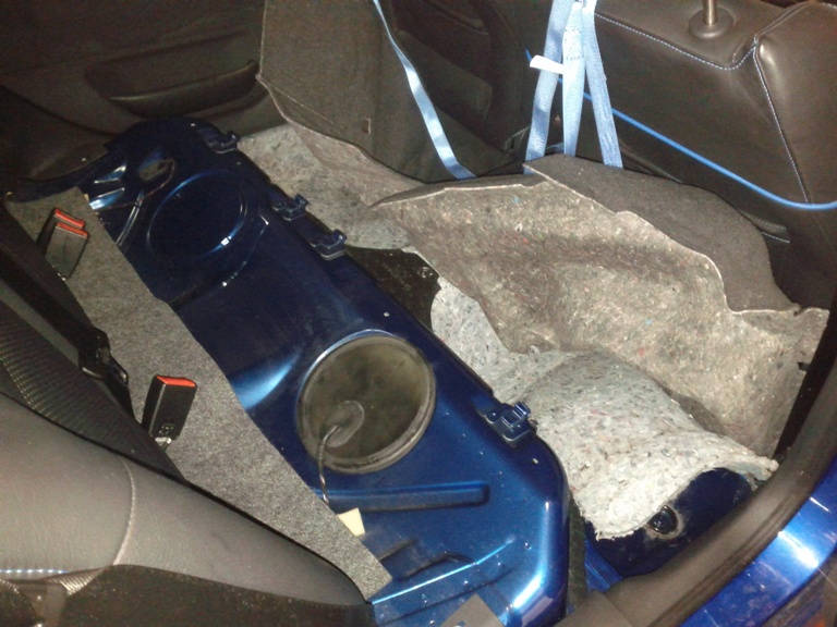

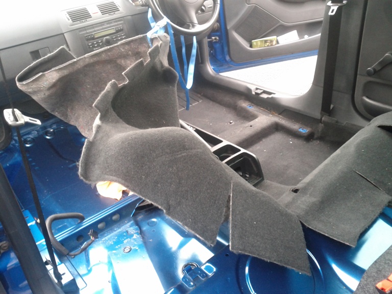

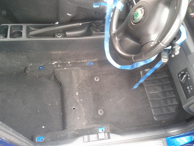

post-73461-0-82154500-1338927879_thumb.jpgpost-73461-0-82154500-1338927879_thumb.jpgpost-73461-0-49334000-1338927869_thumb.jpgpost-73461-0-37756600-1338927853_thumb.jpgBought My Fabia at Xmas, Wondered why it was always steaming up then I felt the carpets and they were like sponges.
Only one thing for it and that was to pull the lot out and dry it all.
I hung the floor insulation in the house and let it dry for a day,
Also sealed all the doors up with good quality sealant.
