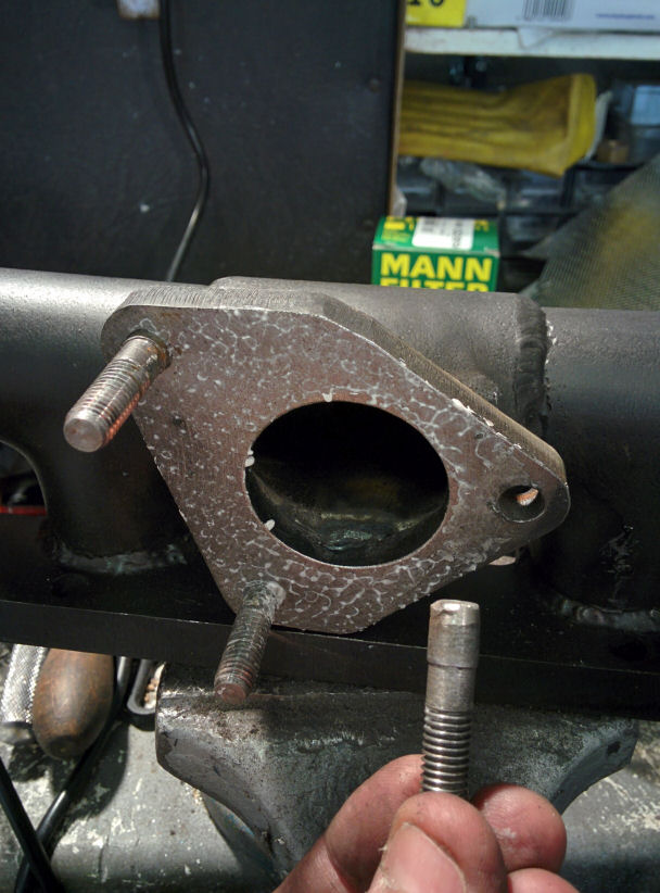

I also have the profi diesel log exhaust manifold on mine with the GTB1756, one thing you may want to check is the turbo to manifold studs, on mine they were just pressed in and one of them came loose and caused the gasket to blow, I had to take the manifold off and weld the studs to the manifold (through the holes in the back side of the flange). I did tell profi diesel about it so hopefully they have improved/fixed this problem.
I have the exact same manifold, but they have improved the design since then, The lugs are now threaded in instead of pushed in.
That's good news, was bit of a design flaw pressing them in!
I completely agree, at least they changed the design and listen to customer feedback.
