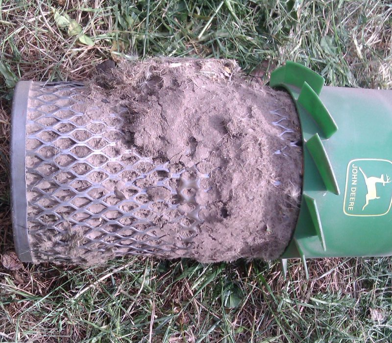

At least another 3 years. There is no signifcant dirt in that filter, it's just discoloured by soot from traffic.
What was your filter restriction gauge reading? Dunno.
Was your car losing boost or down own power? No.
But it didn't look like a new one.
Here is a picture of a filter that is actually clogged and hitting red on a restriction gauge.

That filter has been on the car for 3 years and is filthy and as such, is restricting airflow...so Ive changed it
Good luck with yours
On the issue of filter restriction, maybe you should keep the old one Chris and we'll do some logging of airflow and MAF readings in VCDS.
Except for the fact that it's a forgone conclusion that the new filter will out-perform the old one of course....
It's not the colour of the old one I'm concerned about, maybe that's been the misunderstanding? It's the fact the old one is clogged with debris, which will restrict airflow rate.

You have assumed it is restricting airflow. But there is no evidence or associated problem to show that.

See filters are designed with massive extra capacity to be able to accumulate debris without choking the engine. You won't lose any power until the filter becomes a significant choke point. Which is a small fraction of it's original area.
If you actually wanted to do an interesting filter experiment, get a can of spray paint and progressively seal more and more of the filter between runs. See how far you have to go before first getting a measurable pressure difference and then losing measurable boost and power.
But I have zero confidence in those who state facts and outcomes before performing experiments. They tend to subconciously or otherwise distort the results to fit with their pre-conceived notions.
