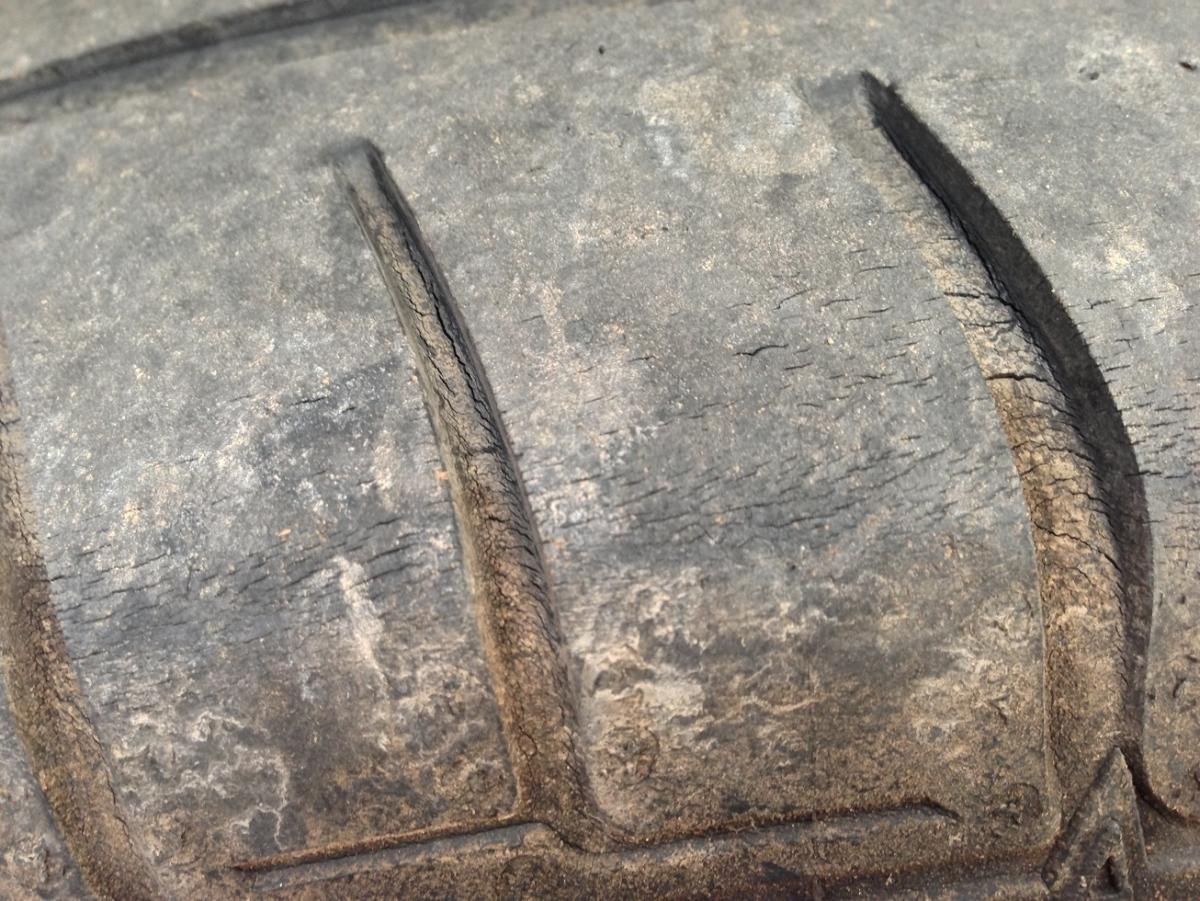

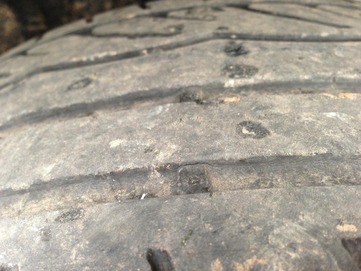

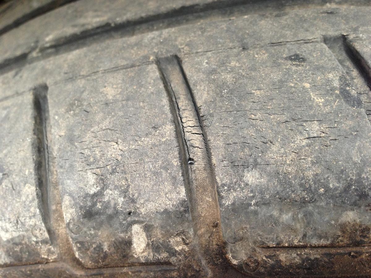

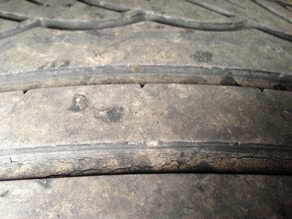

Ive spoken to the garage I bought it from and am trying to convnce them that they shoul dnot have sold it like this, and they owe me 4 new boots. Heres some pictures I'm about to send them as evidence (they asked for them). You can see the poor condition of the tyres.
Those tyres look shot to me. Today I replaced all 4 tyres on my mums 11 year old, 40,000 from new Golf. The Golf tyres were less cracked. I did notice that tyre noise was less on the new rubber ( contis).
Are the photos just of the rears?
The tread blocks on the shoulders look saw toothed to me. General tread depth wise they look barely legal and would attract an 'advisory' if being MOT'd, if not a fail.

All 4 are like this. The pics are from two if them that had the light on for photos. The other side was in shadow. I expect this is why they lost pressure too.
No not a main dealer. I'm annoyed that I missed this when buying but a combination is 25psi Bd all the tyre dressing hid it a little.
Just heard back from the supplying garage and their 'technician'. Apparently tyres in this condition ("weathered") are fine and they are happy to sell cars with tyres in this condition. I feel like a fool for not being more thorough when I bought the car now as this is likely to cost me another £500 :(
The tyres are shot.
They aren't "weathered", they are battered.
I know the car has done 42K and i'd expect them to be worn but for the rubber to have perished how it has is surprising.
Are we sure these aren't some part worn junk they've chucked on?
