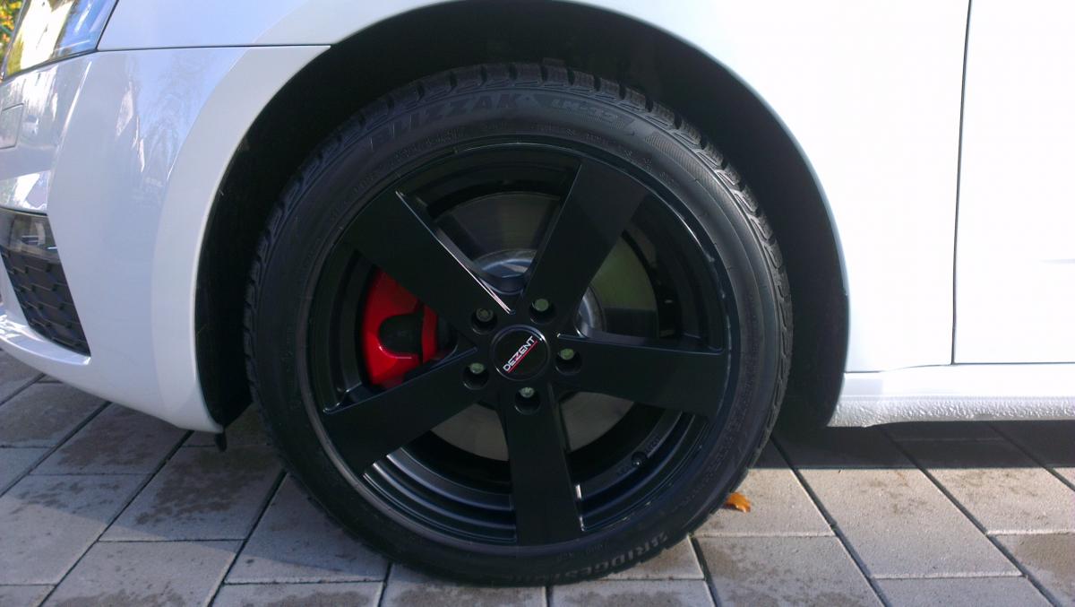

Winter wheels / tyres now fitted. 7.5J x 17 ET40 Dezent TD Dark (black) with 225/45/R17 94V XL Bridgestone Blizzak LM-32. A good 3mm of space between the calliper and the rim.
Edited by Black_Sheep
How about the ET, isn't the wheel coming a bit too much to the outside?
Well the ET for a standard 18" wheel is (apparently) ET 51, the rims I have are ET 50, I would like more clearance than 3mm between the wheel & the calipers, something like 5-10mm would be more comfortable in my mind.

Not too much further than stock. Was matched against Tüv database for sizes to fit to vehicle and have the paperwork to keep the local police off my back. Looks clear of the arches but l doubt that I would be able to fit snow chains - I think this is why I was given the the 7J x 17 size initially by Skoda.
I'm now starting to wonder if the H rated ones will be OK for the vRS, I most certainly hope so.
Well, I asked since the recommended ET is 51, so 40 quite some way off. I'm glad it's still ok though, it's a good guide for us guys/gals who haven't got winter wheels yet.
