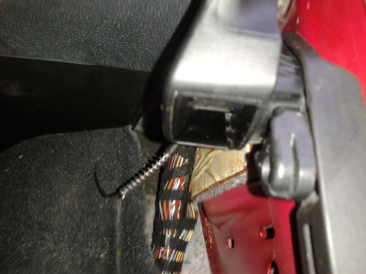

Opened!

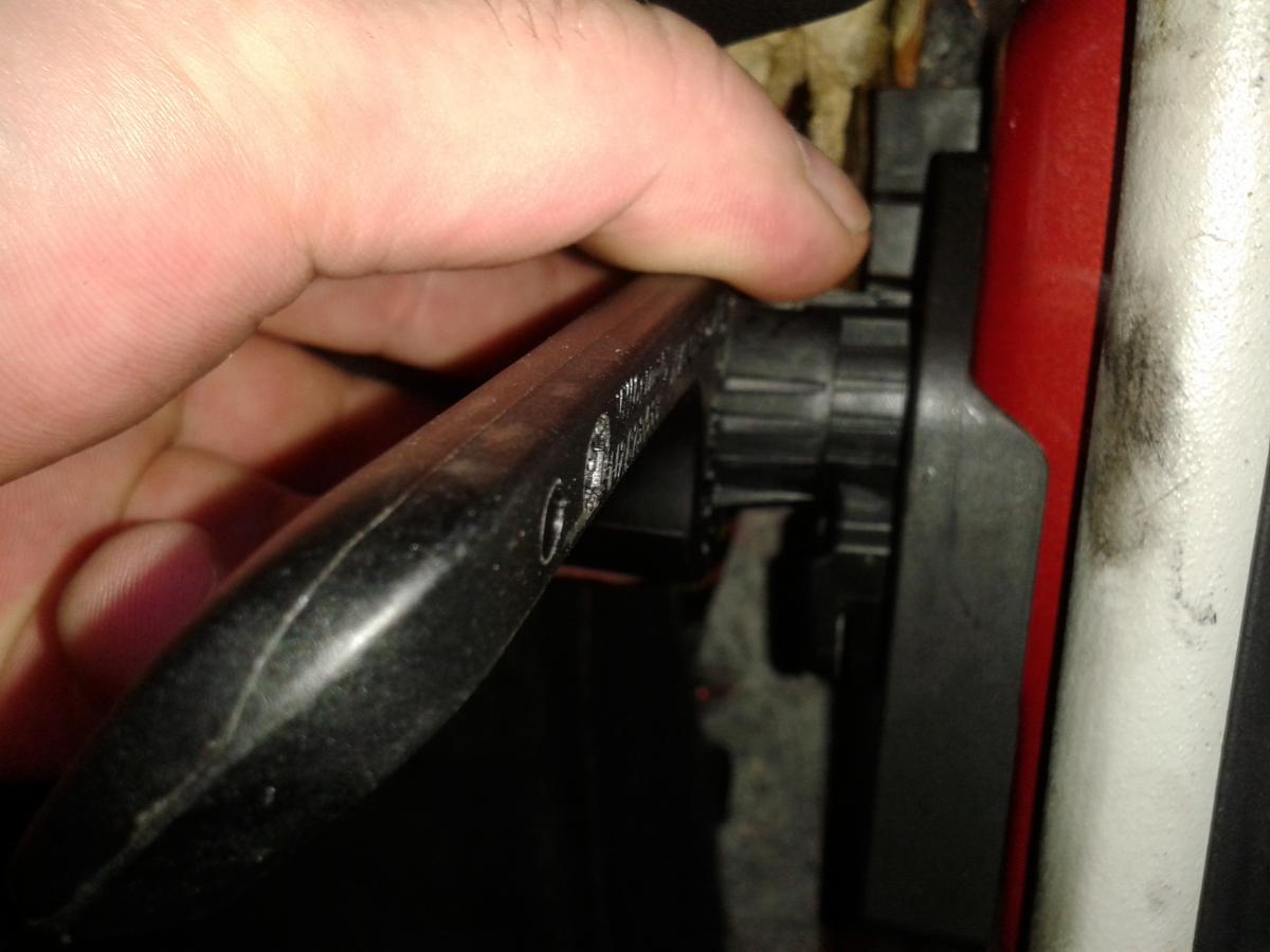

1. Pull the bonnet release handle towards you to expose the under side.
2. Use a flat bladed screwdiver to release the retaining clip by pushing the end downwards.
post-73816-0-41982900-1379866175_thumb.jpg post-73816-0-36309700-1379866314_thumb.jpg

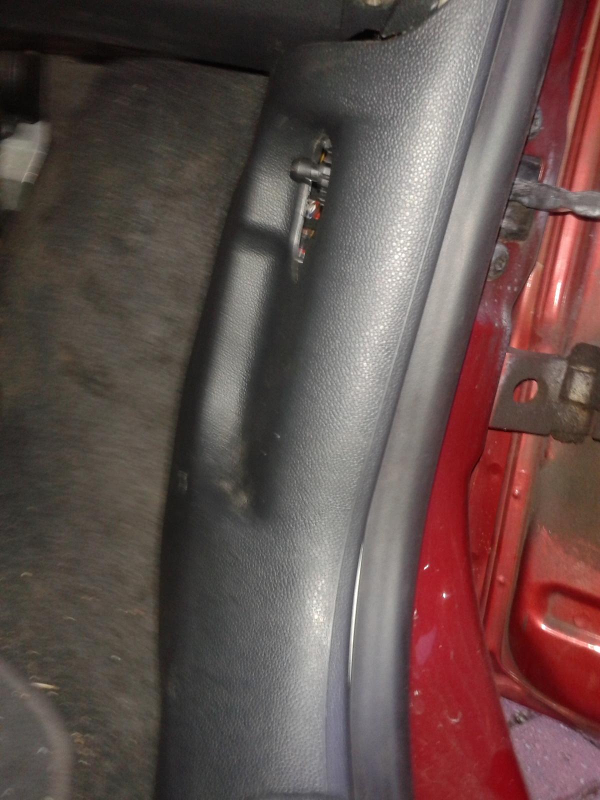

3. Grip the handle between forefinger and thumb and pull to the left
4. Remove the plastic trim that surrounds the handle. It's in tight!

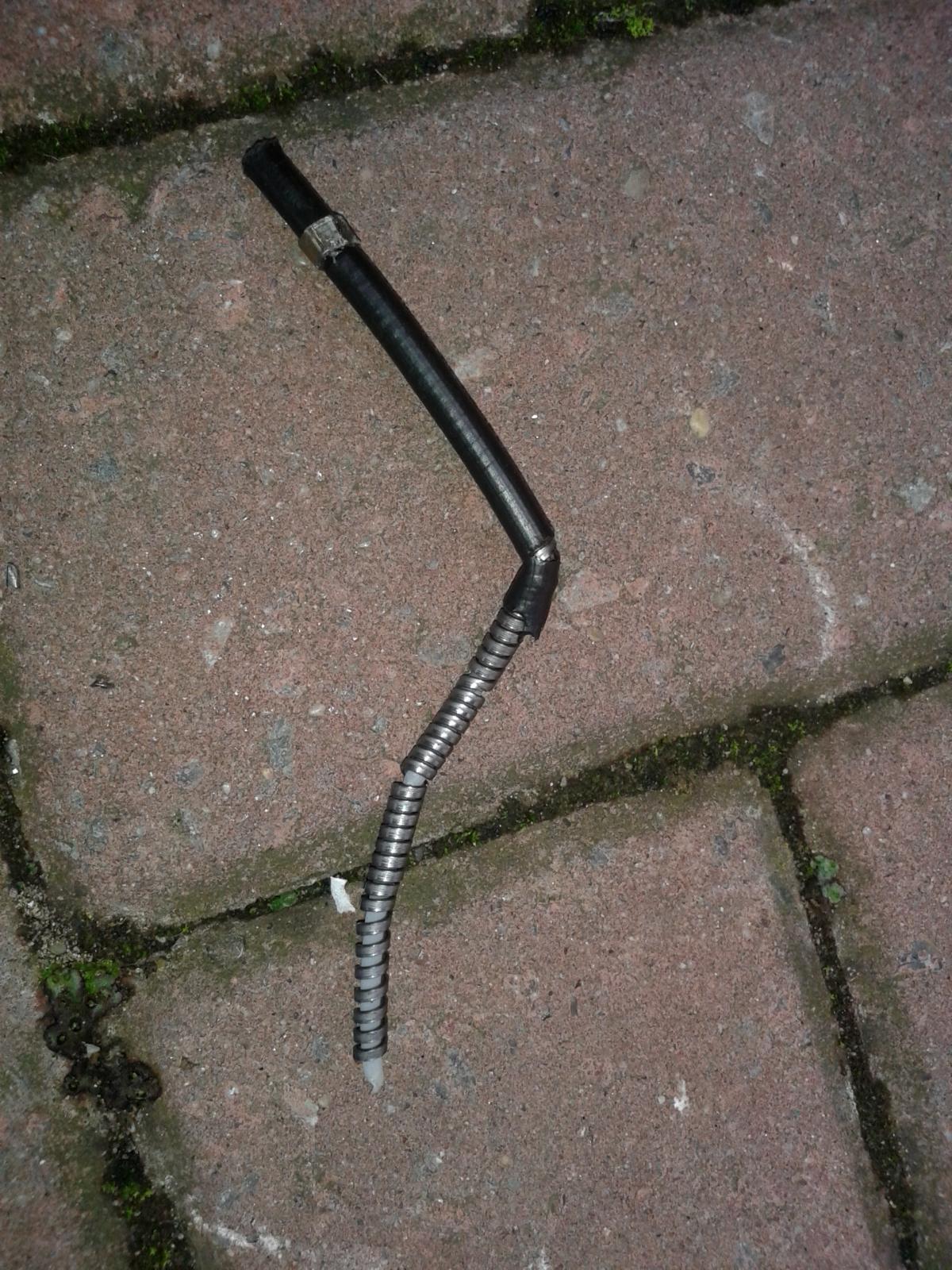

5. The detached cable should now be exposed. It's likely that the ball joint that's attached to the steel cable has broken(it was in my case)
6. If the steel wire isn't visible, you may need to cut the sheath, the steel reinforcing coil and the internal sheath to expose the steel cable. Be Careful!
