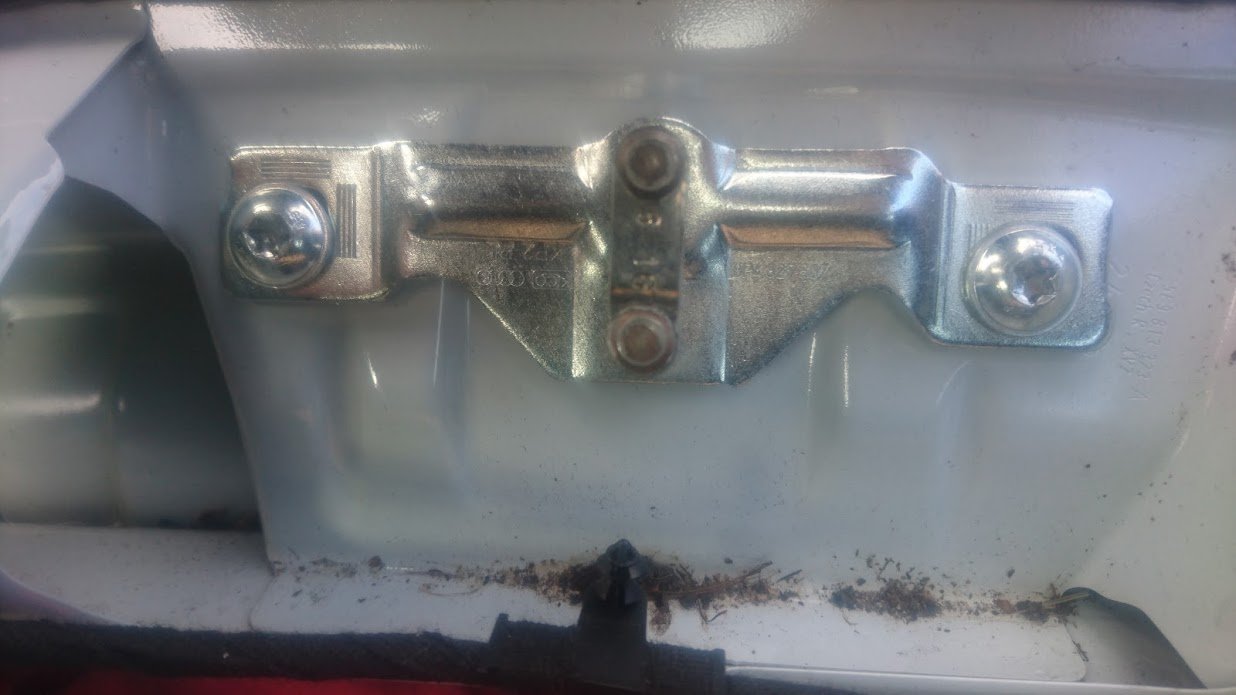

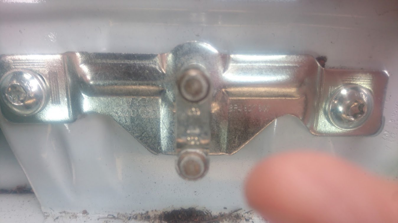

  • My VRS 230 hatch (demo 900 miles on the clock) exhibited the booming / pressure in the cabin on the pre-purchase test drive. The dealer acknowledged the issue and gave me written confirmation they wo
  • Have you tried adjusting the striker plate as well? In my case the buffer adjustments did not solve the booming issue, I had to adjust the striker plate as well. My boot lid closed too easily ie. wi

as other suggested, i've tried to adjust the rubber boot stopper with 2mm inwards, this solves it for me, however, my wife then cannot stand the car.

However, when i fiddle with the rubber stopper on the boot and set it to 2 lines, instead of 4 from factory, it is better for me, but worse for her :-p

I adjusted my boot latch fully out and the noise was reduced massively.
-Unfortunately, there was also visible daylight between the tailgate and the body.
I didn't adjust the side guides from their original positions.
I moved the latch half-way back to the original position and will monitor it.
I am intrigued as to what the mechanism is for this booming and why opening the boot makes a difference. It could suggest a pressure issue...

Interesting stuff.
My car produces the pressure wave at low speeds, say 15mph+.
I adjusted the metal closing latch. See pictures. I didn't adjust the side stops.
From looking at that video I initially prevented the seal by unlatching the boot and by moving the latched position outwards before moving it back in a little.
What I possibly should have done is retain the seal with the orginal latch position and move the side stops to constrain the tailgate more.
-The tailgate does still feel firmly held anyway, though.
I will experiment with the side stops.
