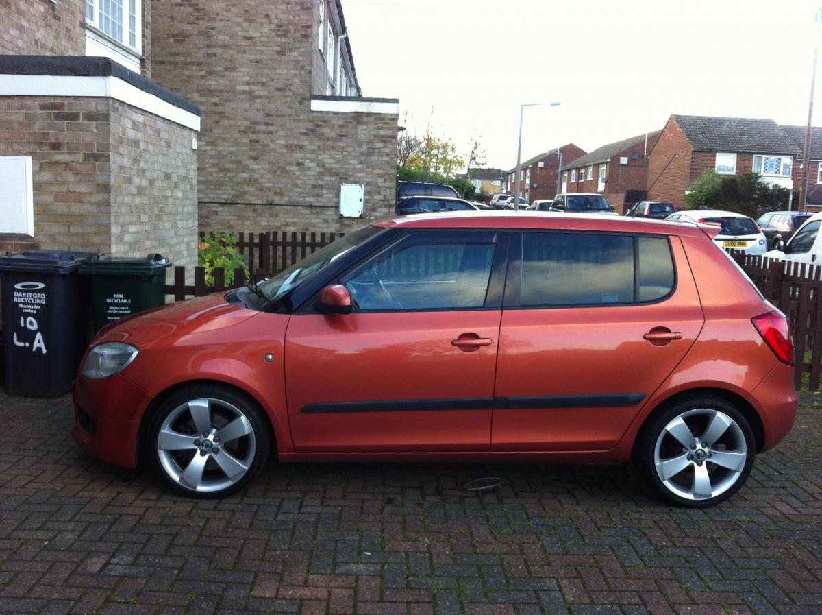

I have swapped these with my previous trinity monte silver alloys I had. I was over the moon with the deal we agreed with the top man (Combi31) and PX my wheels, gave him some cash for the Kenataur ones. I'm really happy with the look, car looks much better but i want to make look even better hence why asking the questions about spacers and ARB...I also have a mate who can refurb each wheel for £25.00 per wheel and planning to paint these while using my Winter Set to look like these Audi ones:
I was not planning to spend extra money on her but me and wifey deiced to keep her for another 3 yrs and I want this car to be and look mean...!!!!
