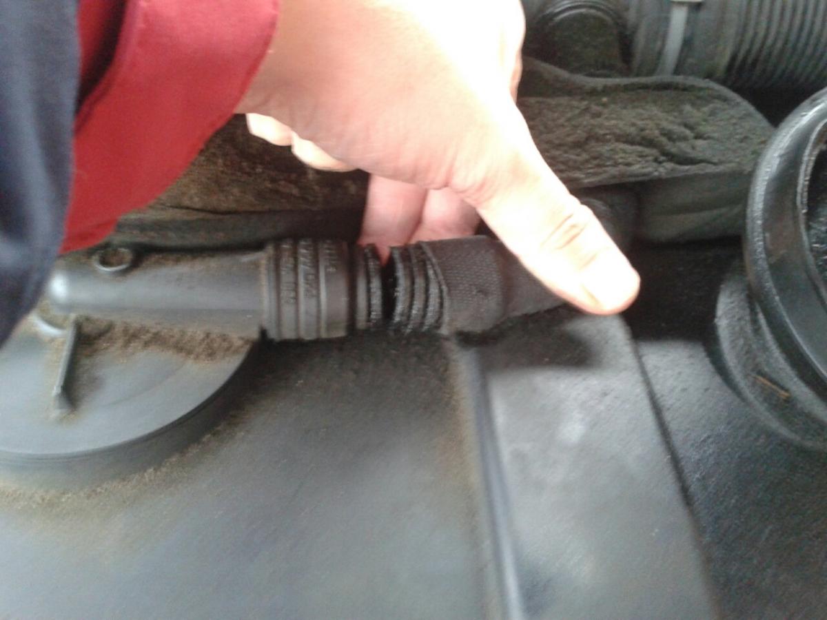

I think I may have a brake issues caused by a leak in the vacuum hoses somewhere, so I was having a look today at the hoses and noticed this.
I understand this to be the breather hose from the crank case and that some of the oil from here helps to lubricate the turbo. As you can see from the pics the hose is knackered. Not sure it'll actualy do a great deal, but at least it'll stop oil coming out onto the top of the engine.
I was looking to just replace all the vacuum hoses with new silicone ones to see if that clears up the brake assist issue. Is there a guide anywhere? I can see me getting the wrong sized hose or missing a section that might have a leak.

Dependant on how bad the split was you should see some improvements in performance as the MAF is receiving a specified amount of air just after the airbox and due to the intake pressure of the turbo sucking in all that air you'll be getting excess air from that split, so it will be running ever so lean = loss of power.
Worth while upgrade is to do the elephant mod whilst you're at that stage! Haven't heard anything about the oil being used as a lubricant for the turbo though. Should have sufficient lubrication from the oil feed?
There is a hose which is prone to splitting which does affect the brakes. I don't know too much about it though, or which hose it is, so hopefully someone who does know will be along soon to help you with that.
mine split, it comes off the back of the engine on the right hand side, can't just buy the bit that's split either you have to buy the full brake servo hose which goes from the picture right back round into the servo. Ball ache and it's about £25
