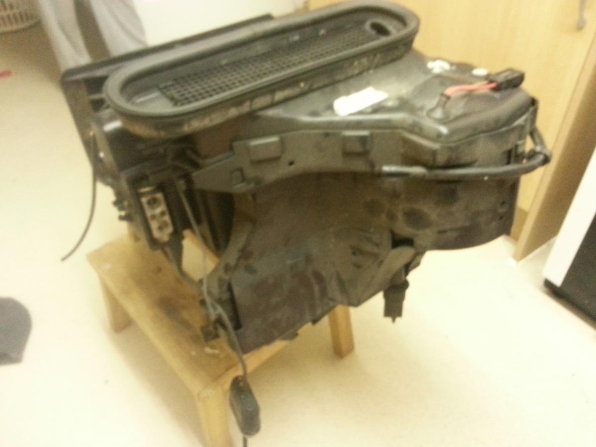

  • I uploaded some photos for you. hope it helps understand what is in there.   http://radikal.cc/users/dohnjoe#alb=fanblower
Thanks, but this isn't the same as mine, because I have the model with air con. I have the same one like the one that uma1998 posted before.

Comparing uma1998's photo with those that dohnjoe posted I think the fan unit looks similar - you can see the same shapes in the casing at the air intake and back to where it mounts to the bulkhead. If it is then you may be able to use or adapt parts from the standard system.
