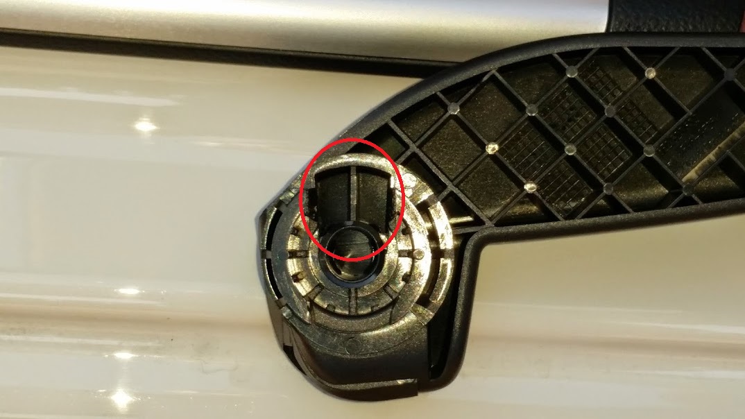

Has anyone managed to do this on a late 14 reg, only as much as I try the bonnet lever will not budge and I'm worried about damaging something. I've now tried that much, there appears to be a small amount of play in the operation of the lever, but there is still not movement backwards or forwards, as though it's coming off the attachment. Think I might have to live without footwell lights!
Sorry to keep on about this, but can anyone please help?
Have you removed the locking pin?
I don't think so, where is this/how do I remove it?
Thanks for the help andyvee!
It is  the black U shaped bit just above the centre of the hole in that photo. You need to slide that away from the centre of the handle - it engages in to a groove on the shaft.
Circled in red
You are looking at the rear of the release lever here, and the U shaped bit has already been removed. You should be able to work it out from here :)
Circled in red

Circled in red
Sorry if I'm being thick andyvee, but my technical knowledge is nit that great.
How exactly did you move the locking piece, I don't think I can see clearly how to do this!
Once again, thanks for your help!
Lever it very gently towards the rear of the car with a screwdriver?
No offence intended, but if you can't work out how to get the bonnet release lever off I would recommend you think twice about fitting the footwell lights without assistance
I fitted them with no problems to my 11 reg VRs, but the plug was a lot easier to get to.
Thanks for the pointers, I will have another look, I've just been trying to pull it off as per the previous instructions. Your the first person I've seen mention this locking catch, even the skoda tech I asked wasn't sure how,it came off.
As I said no offence intended, it is obvious once you work it out!
