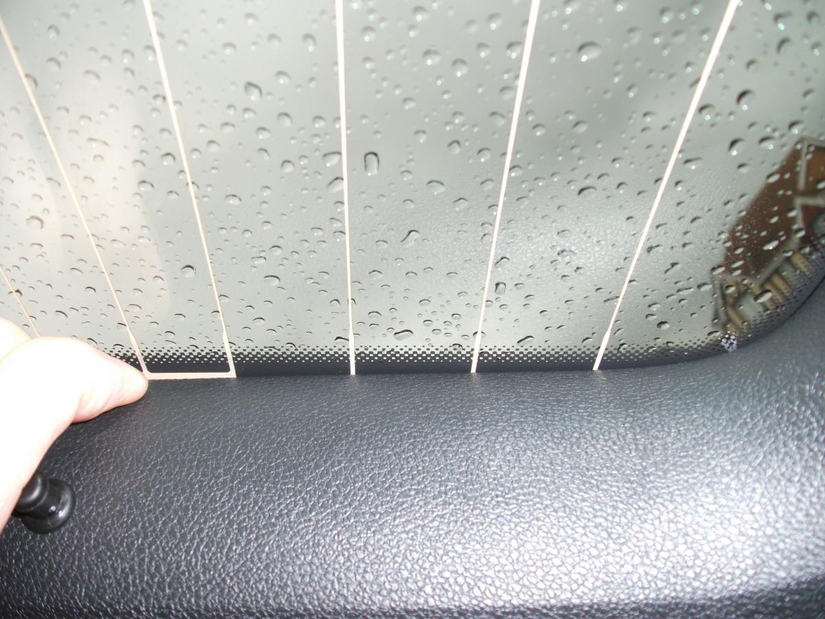

Hi guys, whilst defrosting this morning I noticed that the upper 3 elements on my rear window (hatch) aren't working, these are the three that cross the mid high brake light.
Is this normal or do I need to book her in for some warranty work?

They must be the radio antenna, the combi has them in the rear quarter windows so the hatch only has the option of putting them in the rear window.  I once had an '08 Civic Type R that had the antenna wires across the top of the rear window so i'm assuming the O3 hatch is the same....

Spoken with Skoda UK, can confirm the top 3 elements are the aerial.

I agree, they must be an aerial because they are not connected to the other window heating elements
