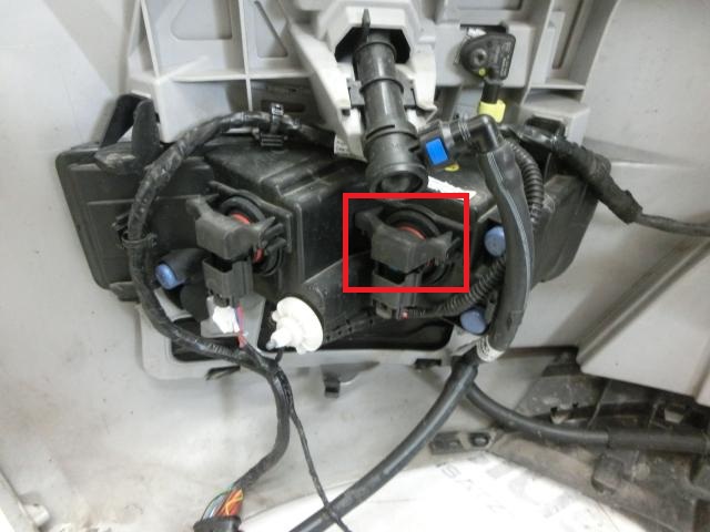

Has anyone changed front fog bulbs? I could access the bulbs by removing the plastic under the fog light but there is a plastic part that I do not know how to remove. I recorded a *poor* video with my phone.

You have to pull them straight backwards from the foglight. Off is one thing, i did not manage to get them back on. Can`t see any problem driving without these plastic locks.

Thank you ahaavi, excellent image! I guess it's for security reasons. I'll try to remove it this week.

Be careful when removing the plastic because you can break the seal (I broke the first one). Use a thin piece of metal for easy removal.
Which way you used to change the bulbs? Did you remove the bumper or wheel well or belly plate or just the plastic part under the fog lights?
Just the plastic part under the fog lights. Use your mobile phone to take photos if you want to see what's inside  ;)
