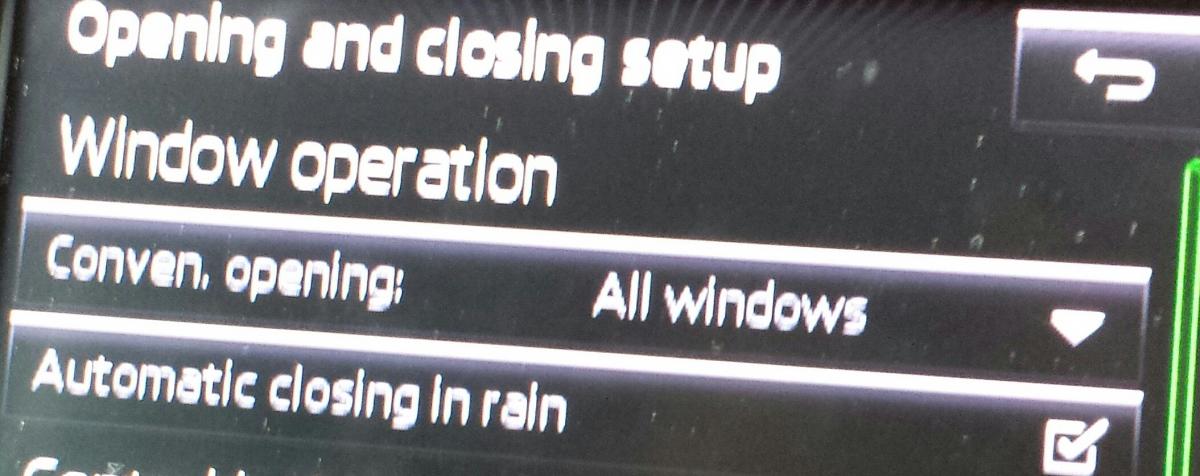

Can someone with a Bolero check if they have this option in Car - Settings - Opening and Closing -Automatic closing in Rain
It was on my list of things to get dealer to enable...but they said they couldnt.
I'm not sure if it was always there or did dealer enable it. Anyway it doesnt appear to do anything.
Windows open- car locked- water poured over sensor- windows stayed open.

The photo i attached is from my car. So it looks like the function is now on it (unsure if it was always there)....just need to figure out how to test it.
I did read on Mk2 that wipers needed to be set to Auto....will try today.
At the moment all that can be done is to enable the option in the infotainment but it doesn't work as the rain/light sensor needs coding aswell and at the moment that cannot be done. I'm in the same situation as you.

Looking at my headunit there is an option to select....but as Neily03 says it cant be coded.

It isn't a feature that doesn't work - in the UK rain closing is not (to my knowledge) a feature available on any MkIII Octy from the factory.
VCDS can make all the necessary changes to the 09 Central Electronics module to enable this feature, but it cannot enable the feature on the RLFS (Rain Light Humidity Sensor), so it doesn't work.
If you have access to VCP you can code the RLFS, but it still seems a bit hit and miss as to if it works. Coded mine yesterday and it doesn't seem to work, but others have had it working!

The option is currently "tickable" on my head unit (I am assuming this came from the factory like that)...so as I see it.... this IS a feature that doesn't work, otherwise it should not appear on my headunit.
I doubt it came from the factory like that, more like that's as far you dealer got when they tried to enable it like you asked and just left it like that.

There is some criteria that has to be met before the rain closing actually activates. From another forum...
The windows only close automatically when:
(1) You've enabled the feature in VCDS and in the car menu
(2) The car is off
(3) The doors are locked
(4) The wiper stalk is in the Automatic position
(5) The Rain/Light Sensor (RLS) detects rain OR if x hours pass with no rain or no-one interacts with the car. Usually this occurs overnight in my experience.
