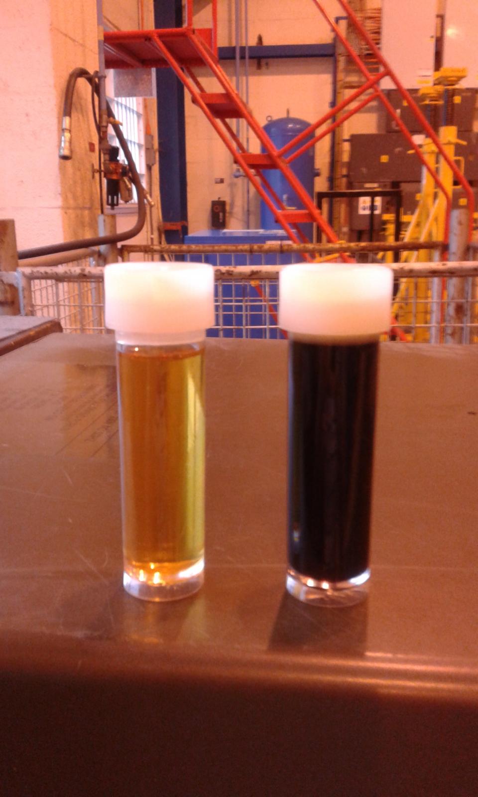

The VAG "lifetime" transmission fill is anything but. I swap gearbox oil every 4 years, I once swapped after 6 and got similar result as shown in the photo (and I did swap the fluid due to diff noise, the new fluid cured it). Gearshift definitely improves as well, so long as you use the correct fluid.

I carried out a full service on my car today & also changed the gearbox oil,glad i did when you see the state of the old oil that came out(picture of old & new oil). I also changed the fuel filter & the colour of the petrol coming out of the filter was brown!. Car is a 2008 octavia vrs TFSI that has covered 54,000 miles.
Mines a pint of best not the Guiness
