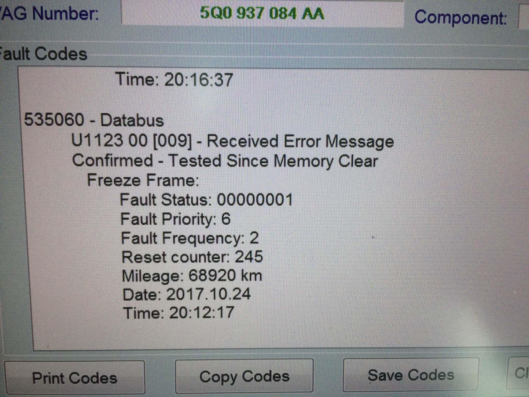

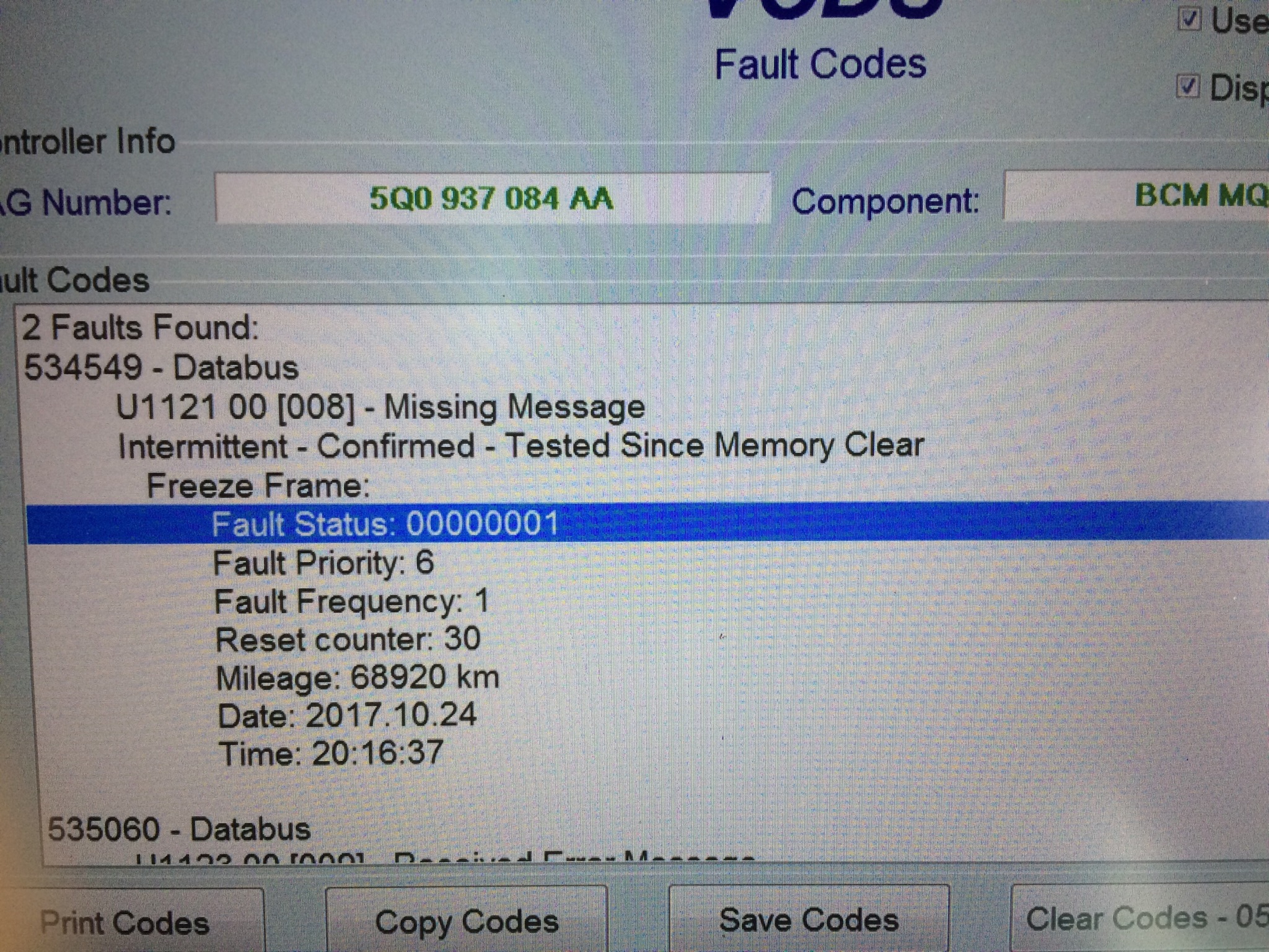

These are the 2 fault codes I have, im sure it’s something stupidly simple that I have missed! (It still isn’t working as soon as you turn on full beam it flags the fault and goes back to being as per normal manual full beam on and off)

Had another go at this tonight and cracked it! One of the other posts I read said to clear the fault code after coding 09 Cetral electrics. This is not shown in the VCDS page.
did that and it seems to be working now while sat on the drive, the auto symbol comes up and stays on where as before it would flag a fault straight away.
