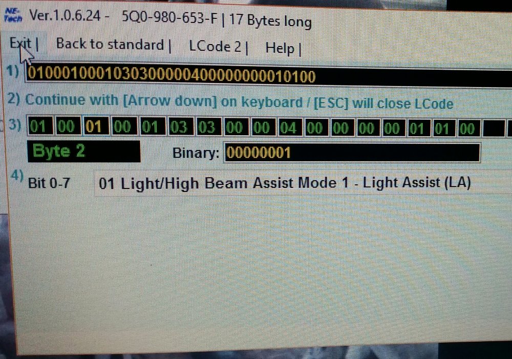

Hi,I have followed this guide to enable HBA.  I have carried out the first two parts, But I am struggling with the final part.
Access Module A5
Go to Long Coding, change byte 2 Bit 0 to a "1" or use drop down menu to select "Coding_light_assist High_beam_assist
This is what I get when carrying out these instructions.20170131_175437-1-1.jpg
I am pretty new to vcds so I apologise if i have made a blatent error.Thanks for any help or guidance.
