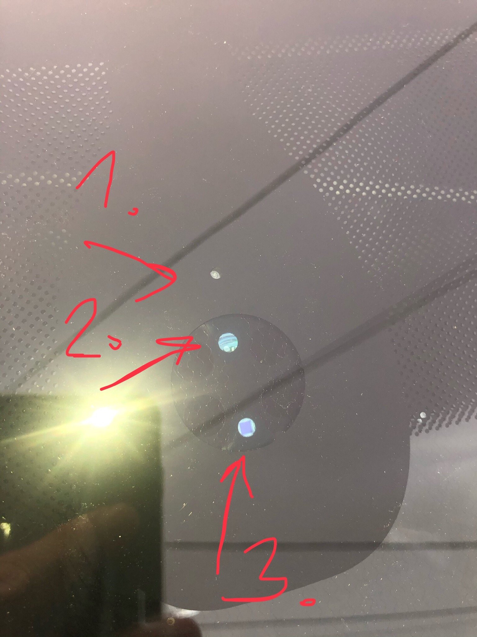

That's a pic from my car,
I see 4 sensors?
1 rain
1 light
Both are inside a black cycle
1 light for mirror
1 inside a grill , what ta hell is that for

Hi,
My2019 Octavia has 3 “something” font of the mirror. Someone know,what are they? I have LED front light with auto on/off, and auto wiper. I have drill back of the mirror, not a camera.

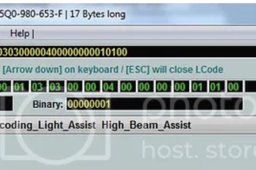

can i change speed of ON and OFF HBA with hba sensor (camera)  in mirror?

Sorry to bring up such an old thread but i'm recently in receipt of a Hex V2 interface and I'm making a few changes - namely the HBA.
I am running a 65 Octy Scout without xenons but with lane assist and I note in the guides it says "change Byte 2 to Hex 09". Before I make any adjustments, does this mean to change the binary to 1001?
Sorry if this is such a noob question but I want to be sure before I start messing about with things. Safe to say that the software has had a number of updates since this guide but i'm making my way through it so far (I think!)
Also I run the adaption map before anything else as instructed.
Thanks for you help!
Binary - 1001 is Hex09 or Decimal09.
Cool so where it says 0000001 in the photos (for example) I just amend that on the byte and bobs your uncle?!
I think I managed to get this to work so thanks for your help!
