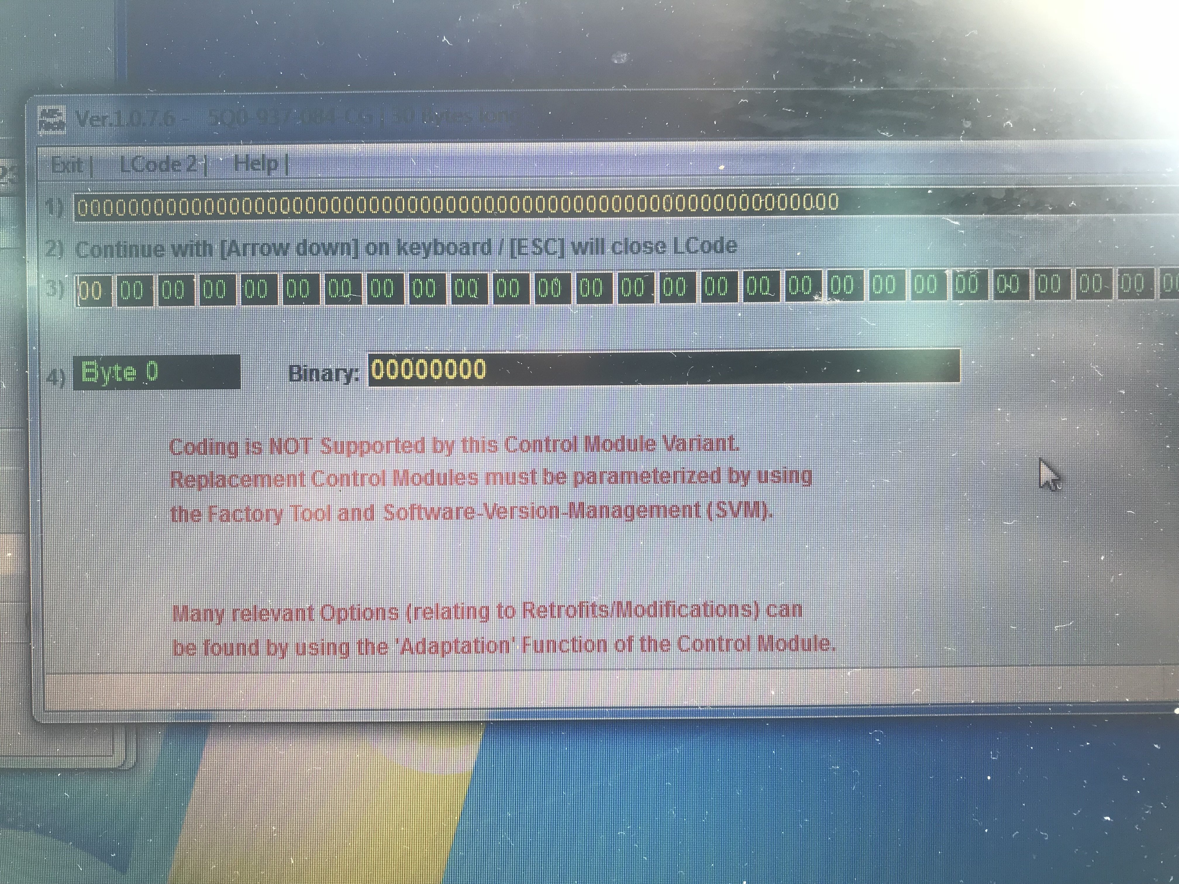

Byte 3, check/tick bit 2,  >>> I dont have this...
Im using VCDS 17.8 version and I get the following error message, see attachment:

Newer modules don't use coding any more, only adaptation channels (as the message suggests) - the clue is that the coding is all zeroes.
So what is it then by adaption? I would like to activate High beam assist for skoda superb 3 2016, can anyone help on this?
i use this VCDS code: https://www.ascoding.ch/en/activate-light-assist-2017/
Try updating to the latest version of VCDS 18.2.1
Also, what cable are you using? Only the Hex-V2 or HexNet can access newer modules.

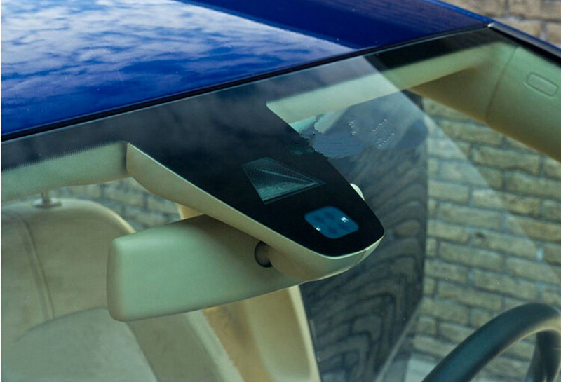

This is an example lowline camera:
This is an example highline camera (cutout above the RLS):
@Loada - Any chance you could take a cheeky snap of your rear view mirror assembly from the outside?
My old car MY14 1.4 TSI ELEGANCE (SE L) had only the lowline camera & that had HBA so it must be do-able

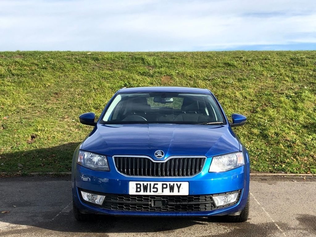

I have RLS (i.e. Bi-xenon lights, with AFS, coming home, auto lights and rain sensors) however I don't have anything pictured in the above.
I'll double check but I only have two little dots visible on the windscreen (where the mirror is attached) and what appears to a grille (similar to the microphone grille) where the camera is shown in the square above?
47 minutes ago, themanwithnoaim said:
There's no confusion, the MY14 Elegance didn't have front assist, Active Criuse Control or any type of camera other than RLS but, it had HBA.
What's confusing?
It's confusing as statements like that make it appear the RLS is doing HBA.
The RLS is not a camera and it cannot perform HBA. However, low line camera's are often built in the rear view mirror mount which is probably where the confusion is coming from. The RLS should show as a subsystem to the BCM whereas a lowline camera will appear as a separate module at address 20.
I assume you actually had a lowline camera fitted below the RLS much like the Octavia below. You might need to zoom in as the picture isn't idea ;)
