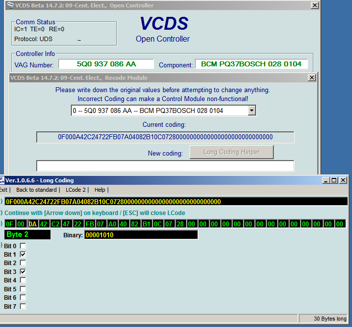

I can't find anything that shows up as the "5Q0 937 084 BCM MQBAB H H16 0124" control module shown in the screenshot at http://i1041.photobucket.com/albums/b413/Philip_Mitchell/HBA/HBAstep7_zps6c4d4212.jpg, the closest I can find is "5Q0 937 086 AA BCM PQ37BOSCH 028 0104".
If I look at the "Current coding" for the module in my car it looks identical to that in the screenshot above, with the exception of the bits in byte 2 that have been changed, but for me VCDS doesn't show a pull-down for bits 0-2. Should I just manually set byte 2 to 0x0B? Or is it possible that Skoda have changed the config of the latest Octavia vRS models and that enabling high beam assist is no longer possible?

It will be possible, you need to do the coding manually then by editing the binary value. Use VCDS 14.7.2, the 12 versions are fairly limited on the MQB platform. Controller and module 09 are the same, the BCM, or as VCDS likes to still call it, Central Electronics.

Can you post a screenshot of the coding on Byte 2 on Controller 09?

Yep, here you go - at least I think this is the right thing ;-)
Just tick Bit 0 as well and it should work :)
Indeed it does, I had already got brave and set it anyway :-) At first I thought it wasn't working properly as it didn't come on to main beam until I got to about 45MPH, and tearing round a twisty lane on only dipped lights wondering if main bean would kick in was...interesting :sweat: I'll tweak the adaptions down some so I don't end up in a ditch.
