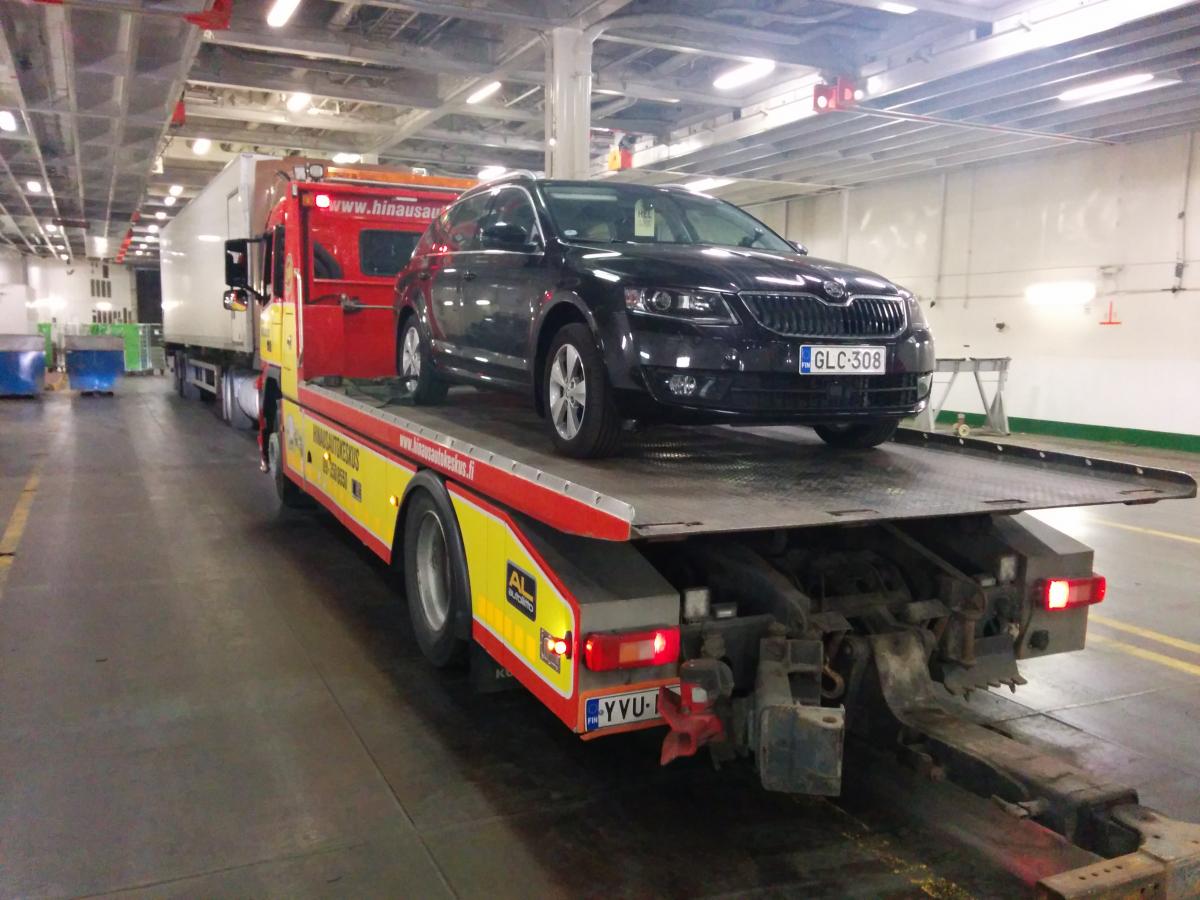

Have to share my documentation of the sad moment last Friday...
