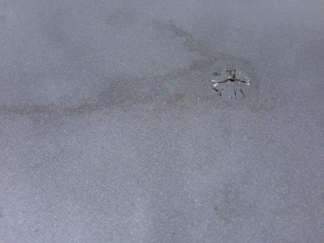

I have noticed some paint blistering around the boot panels.  There are two smaller ones and a larger area on top of the boot lid.  I've attached a pic of that one (hopefully it uploads ok!).  I did hear a popping noise the other day from that area when I was driving but not sure if that's connected or not.  It has been pretty warm and humid recently however it is raining this morning and the paint blister has levelled off a little but now there is a sticky resin coming out of the area and the cracking is still visible and it feels like its going to peel away.

Is that your car or a picture from space?! Doesn't look good. Good luck with the dealer.

Yeah I know the pic looks odd alright like something from space, maybe the aliens sprayed it :)  Annoying in a new car

That looks like either the panel was greasy when it was painted or a small iron particle has landed and dug in and then done what a spot does to your face.
Second look at the pic shows staining, I wonder if someone has either intenionally or accidently put a corrosive fluid on there, could be as simple as someone has put a bottle of white spirit on the boot for a minute and left the spill to dry in and go to work.
The staining actually feels sticky like a resin (more so today) and it appears to be weeping from the area where the cracking is - similar to a blister bursting on your skin.   Haven't been parked anywhere different.

I'm still thinking someone dropped an acid fluid on the car, all it would take is someone to put a can or a cup (like the mongs at work do to me with their coffee and red bull containers) and left unwiped it burns it's way in, it's the staining that makes me think this may have happened to you.

Update:  After reporting this to the dealer during the summer I was informed that Skoda had logged it and were still looking into it and I didn't hear anything since.  Now I discovered that the blistering has appeared on four separate parts of the roof!!  The boot lid still has a crack on the paintwork from before.  The roof areas are similar to the pic I posted at the top of thread - blistering paint spots with traces of what appears to be lacquer draining from them. There are also early signs of this on the bonnet too!  I am obviously lot more concerned about this now and the dealer it taking it a lot more seriously this time.
It is definitely nothing malicious or stone chips and the dealer has acknowledged that.  The only conclusion I can come to that moisture became trapped in the paint process.

Update: Well I have had the car assessed by Skoda (through the dealer) and their final report points to an external substance as the cause I.e the damage has penetrated from the outside in as opposed to the inside out! I'm not happy with this at all as the blistering has appeared on different panels at different times. I've been pushing Skoda Ireland but to no avail. I'm also worried about the impact it will have at resale time of these blisters worsen [emoji35].

It looks like 'pinholing' to me, caused by moisture in the primer.
Just pay for an independent paintwork assessor; I would be really worried about that; hard to tell from one photo, but it doesn't look external. I would personally push really hard, take legal advice, and stop them stringing the matter out. No one would want to purchase it like that, and tbh, repairing it is not ideal. Deal with it asap.

If Skoda are saying that it is an external substance, have you asked them to use their their technology to advise what the substance is. Not being an expert but i would have thought the forensic analysis done by a manufacturer such as Skoda should be able to tell you what caused it. If they say they cannot do this, then challenge them on how they arrived at their conclusion.

Cheers, I did ask them that and funny enough they couldn't tell me!  You're right though, the technology should be sophisticated enough to get to that level of detail - well they informed me that they looked at the various layers of paint so I can only guess it must be sophisticated equipment
