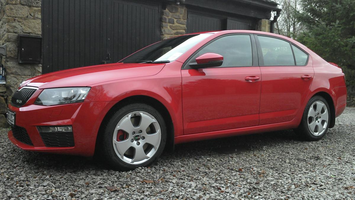

  • Wheels from ebay! From Audi A3. Vredestein wintrac extreme 205/50 R17 89V M+S / 6Jx17 ET48

I have a 2nd set of winter tyres on std VRs Gemini alloys.
plus the Extreme 19" which I wouldn't use as a winter rim.
205/50R17 is a fairly unusual wheel/tyre size - the options are quite limited, although the Audi A3 used to have wheels of this size.
