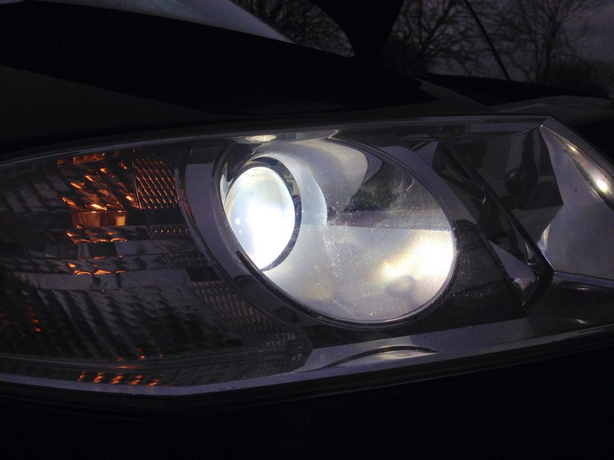

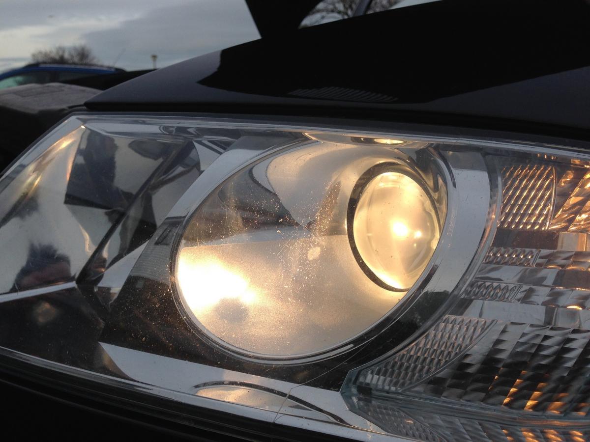

Is this the 4300K kit?
Is the side light working on the 'after' picture?
Is this worthwhile improvement would you say?
It's a 5000K kit
I must apologies for the photos as they were actually taken when I first installed them back in February which evidently shows the cold light diagnostic issue with the LED sidelights at the time. Well spotted though! Thankfully I can report is all working 100% correctly now. Although Mike enabled the North American light setting which means the dipped lights are switched on only when lights are switched off. They function as normal on all other settings.
The difference is literally night and day (no pun intended!) I can see very little difference with full beam (need to upgrade the bulbs as very yellow) but in terms of light output - nice and crisp white light. It's less tiring to drive at night and much better illumination which from a safety aspect is very important.
