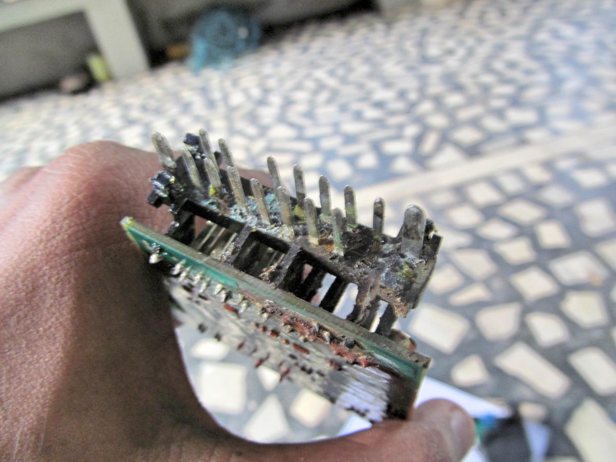

Upon a close inspection I found a no of pins got degraded.
post-113527-0-52521200-1410346390_thumb.jpgpost-113527-0-18440800-1410346421_thumb.jpgpost-113527-0-97273800-1410346361_thumb.jpg
There was no hope of repairing that thing again.

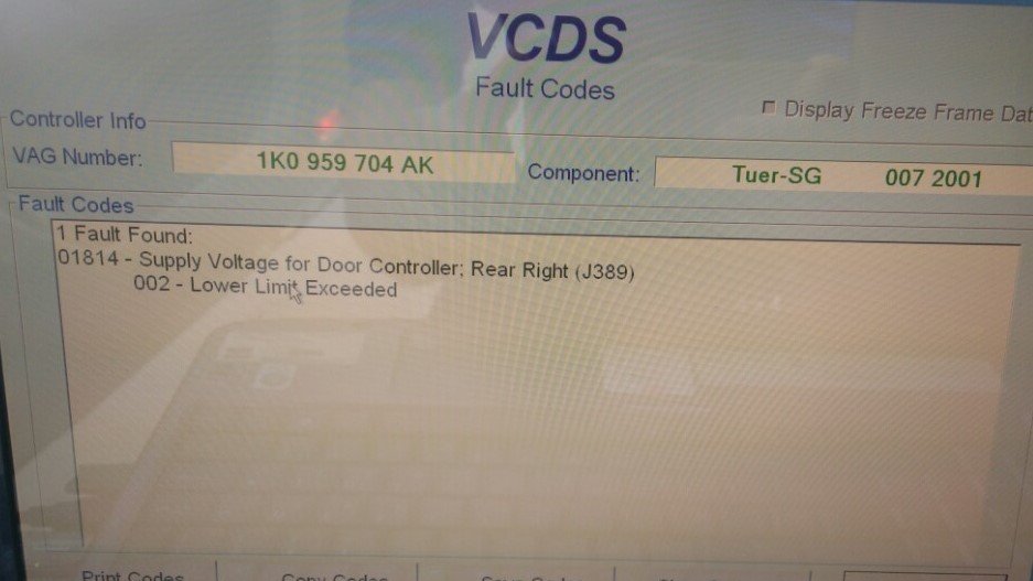

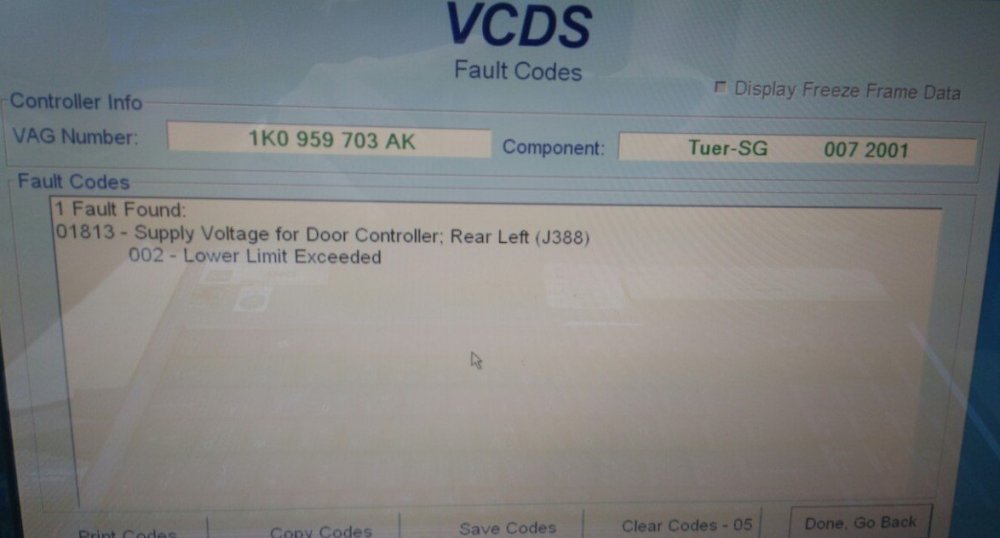

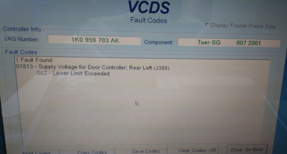

Please help,
Problem appeared at the same time to both of rear windows,
I will appreciate any help,
Thank you
