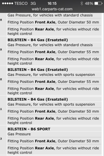

As far as I am aware "sport" was added by bilstein...
No it was not.
By the way, 'Ersatzteil' means factory shock equivalent.
If in doubt, always refer to katalog.bilstein.de
Edited by dieselV6
No it was not.
Oooh... Blue writing!
I stand corrected
But there are 2 different versions. 1 for cars with "sport" suspension. So like B4 "sport" damper?
No it was not.
Though they two versions of the B4, one for the "standard chassis" and one for "sports suspension", and two different diameters for each one

Think the b4 sport refers to stiffer valuing rather being any shorter
The key point to remember is that B4 are of same type as factory shocks (twin tube), while B6 Sports are of monotube design and much better in every aspect bar the price. Hence any use of "sport" around B4 name other than "for models with sport suspension" is misleading potential customers IMHO.
