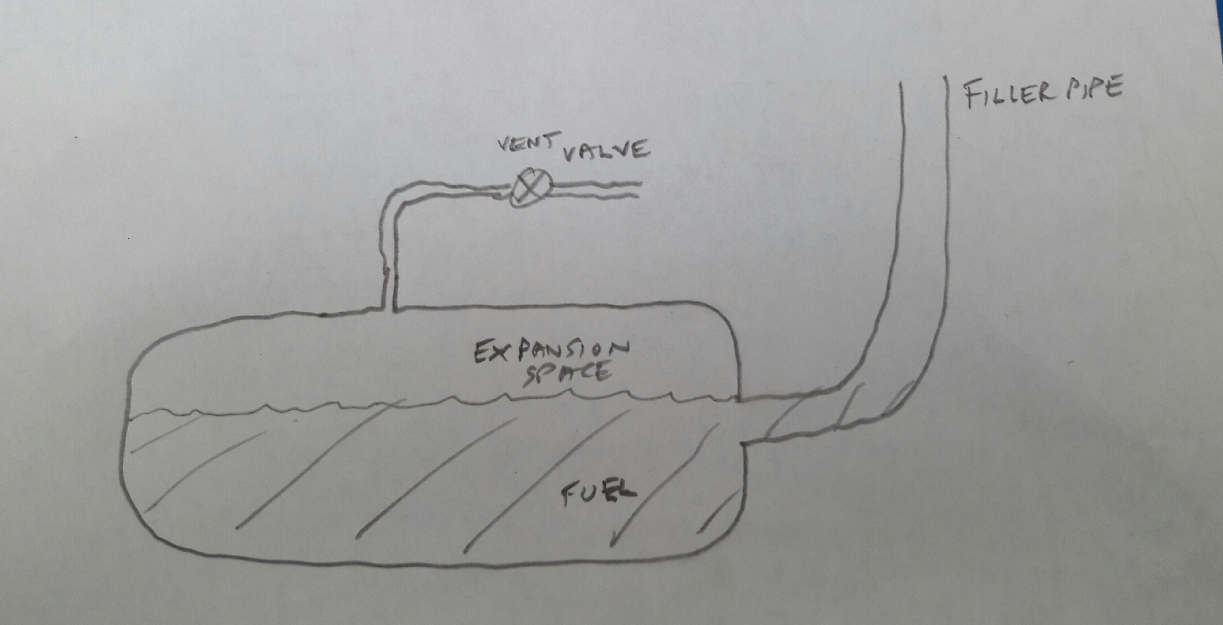

Every car has space to allow the fuel to expand, this is generally called an expansion tank even if it's not a separate tank. By filling the expansion space with fuel you might find that you spill diesel on the road, if the fuel warms up and expands, you might leak diesel or possibly even damage seals in the fuel tank if the pressure can't escape. The expansion space is there for a reason so it's probably best not to fill it with fuel.
  • Sponsor
The expansion area is created by the fact that the filler pipe goes into the side of the tank, part way up, rather than into the top. As you fill the tank, air can escape back up the filler pipe but only until the internal level reaches the top level of the incoming pipe. After  that, as the vent valve is closed, the air/vapour above the fuel is trapped and will compress slightly as you add more fuel into the filler neck.  Once the force of this compression balances the weight of the fuel in the vertical bit of the filler pipe, no more fuel will go into the tank (unless the air/vapour is released by opening the vent valve.
Super simple diagram showing the fuel level at which the expansion volume starts to compress:
Thanks for explaining it nicely..is there any link related with your explanation!
Other thing is  why in different car people do not hear sloshing after over filling them..like my friend told me that he always over fill his mercedes, but never come across of listening sloshing noise.
