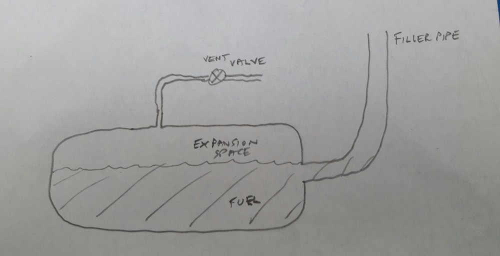

however, if people are filling past the first shut off at the pump that may be the problem as at that point you're not filling the fuel tank but the expansion tank, which isn't a great idea.
