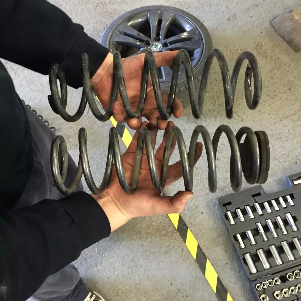

So having had my Monte Carlo now for 2 years ive finally started to tinker.I ve always liked the agressivness the monte has in its best all black form but it seemed to me to be lacking something and slowly i have started to try to replace that missing something. First ill start with my little things. I started with painting my calipers red this was followed by some carbon fibre effect wrap on the little "moustache" above the grille. This was followed by wraping the stereo surround in the same carbon fibre effect. I then changed the map reading lights to white leds with a blue one in the middle. This was the start... the thing that has spurred me forward most is having now had to sell my mx5 which i had extensivly modified i am now wanting to tinker properly with my car so this saturday I fitted 40mm lowering springs the flood gates are now open and mods to come before show season... includeing an exhaust, wheel spacers and maybe more suggestions welcome pictures shall follow!!

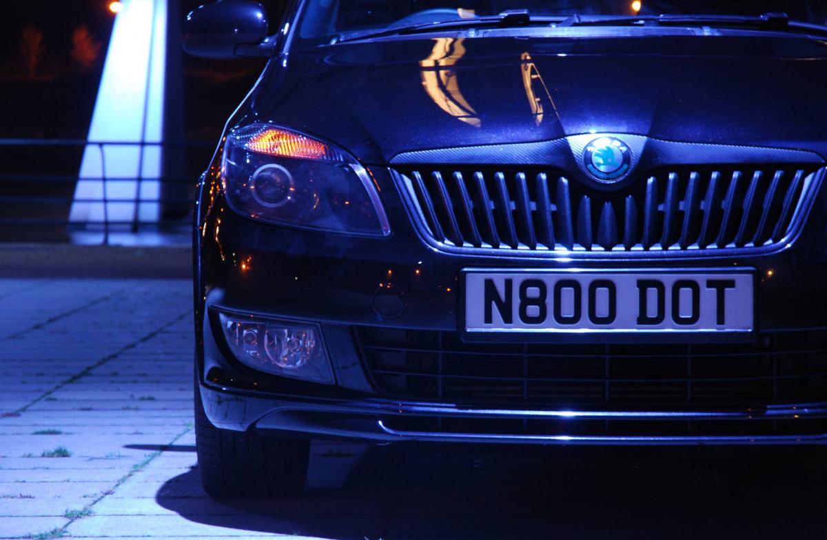

    So here she is with the lights done and i can't believe the difference!!! One of the best mods Ive done im going to do the fogs too if the rain stops. nearly ready for the shows now

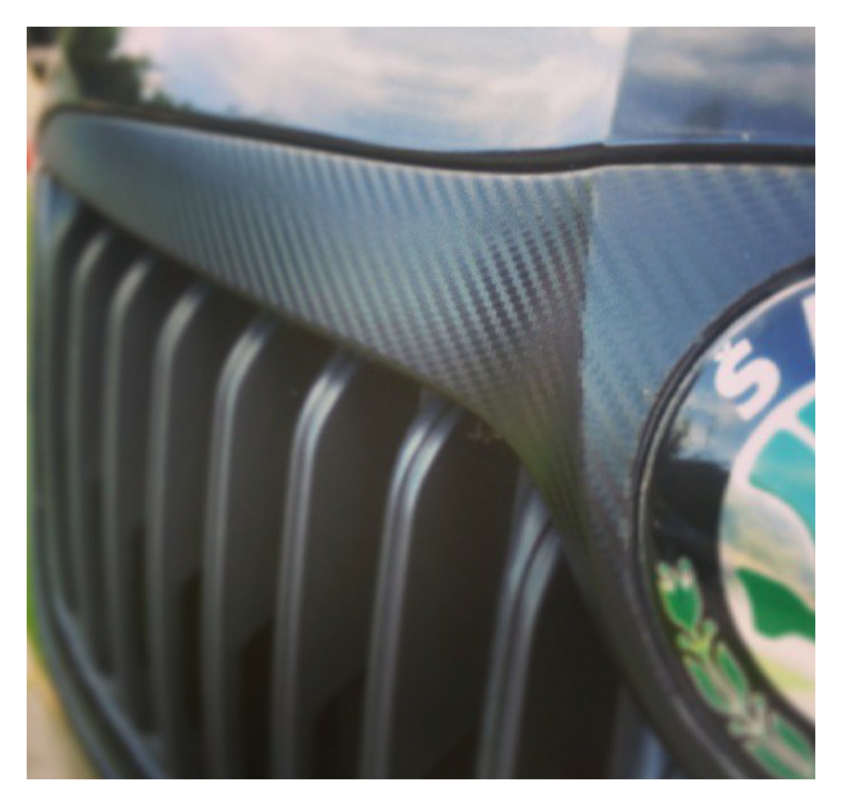

as you can see in the above post my carbon fiber on the outside

the wrap is the premium stuff off amazon and its a case of having to take off the front moustache bit.
pop the bonnet
find the white clips
fit a small socket over them to squash them
pull it off
then cut out a piece about an inch over on each side then using a hairdryer mold the front as perfectly as you can
then using a razor blade cut out the badge
then cut taball around the edge to fold behind it (it doesn't matter what it looks like on the back)

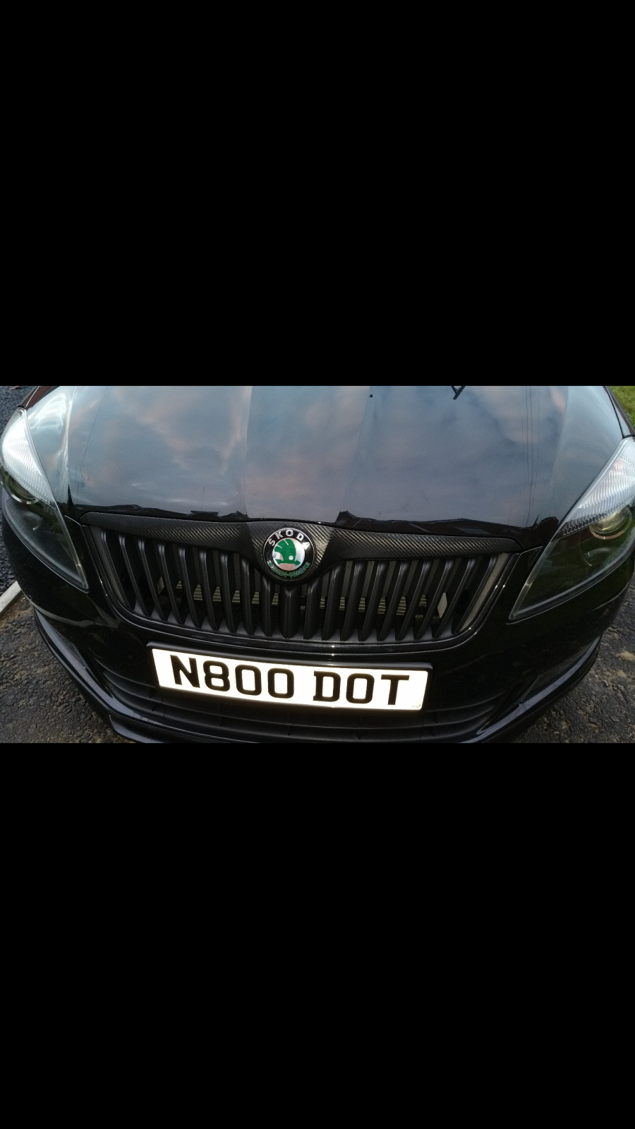

Any more pics of the carbon wrap grill? :)
I shall get one in the next hour or 2 as im off this afty working on my car :)
Debadged it last night which went well
Here aìre the before and shots of my exhaust...
And the grille as requested
