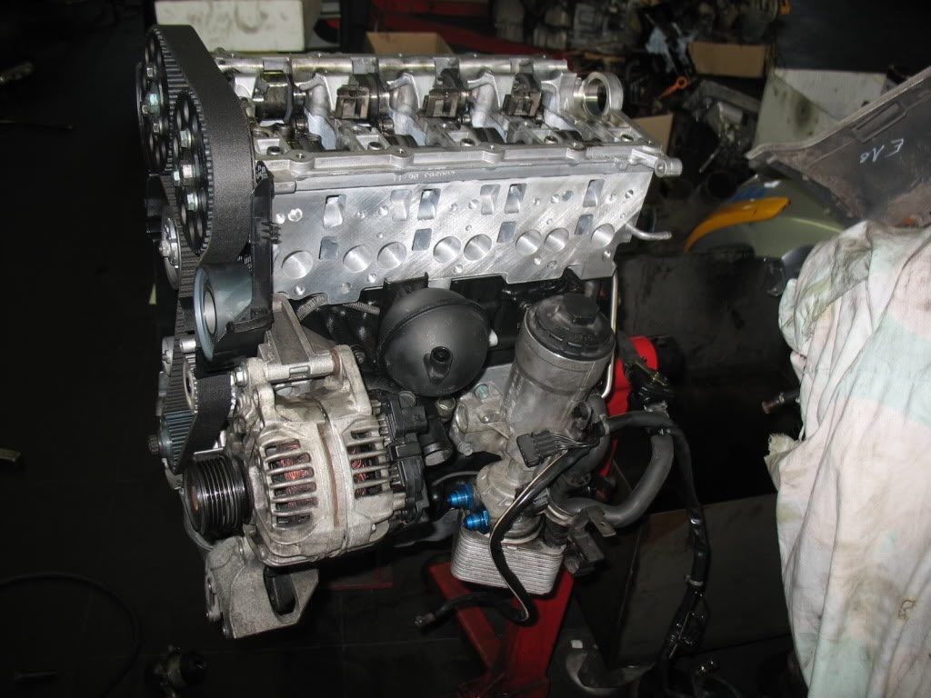

So the bkd 16v head bolts onto the ASZ block and you'll need to bore the block to fit the bkd Pistons. Then play with the cambelt/pulley setup.
Kind of makes more sense to do this as the stock 16v head and cam flows better then a ported 8v head with high lift cam.

Is it possible, yes it is, but requires a fair amount of work.
This was going to be the next step for me if the engine gave way. Just couldn't justify the costs while things were working lol.
I'm having serious think of building one up on the side.
Surely as long as the injectors are readable by the ECU then that is the only thing that could throw a wobbler other than the cam sensor? As isn't the BKD head just a means to draw more air into the cylinders more efficiently.... So long as everything mechanical works together.
I cant comment any further as don't know the technical ins and outs :(
Most here know where the car was tuned and they are the ones who offered it as an "upgrade". But as before its not as easy as it sounds on paper by all accounts.
One of the reasons for using the original block is because the bkd crank sensor isn't compatible.
People have done this and still using the edc15 ecu. Be good to get a spare head and see if the camshaft sensor is interchangeable. As long as you stick with the pd140 and not pd170 then the injectors "should" be fine.

My logic for using the ASZ block would be so all the engine mounting point are kept the same.
That's why I always like your threads :)
yeah I totally understand the merits of using an original unit from a car, but the concept of opening up an engine block and spending top money to have it bore to take bigger Pistons is crazy, whereas an entire 2.0 engine could be had for relatively small cost from a breaker, the metal parts that bolt it to the car are fairly easily to assemble or adapt from existing parts cut and joined together, but if it's solely down to the fact the crank sensor is incompatible then these club Tdi guys are not thinking outside the box enough, even if you had to have a new trigger disc laser cut and pushed onto the existing crank, it's only a transision fit on the rear crank rear nose, I'd even wager it's the same size mounting across both engine types, some plucky individual could even produce a kit of parts needed to do this conversion.
if somebody wants to give me the car and the engine, I'd make it fit and work, certainly won't be messing around changing Pistons round that's for sure.

I'm giving this some serious thought. Been chatting to John.
I was trying to think of a way to test the PD140 BKD injectors in my current engine just to make sure that they 100% work with my current ECU. They are a different shape though unfortunately so they don't fit. What I don't want to do is commit to it, build an engine and find that the damn thing will never work!
Reading about though, I'd be more inclined to mate the ASZ and BKD engines together. You're gonna have fabrication work to do with mountings, possibly gearbox casing issues, and still the issue of management if you swapped the whole engine. As I'd be rebuilding fully anyway, seems a good idea to keep the original block.
Another issue I'm thinking of is bulkhead room. Is there enough? From looking at the pictures, the ports don't really jut out any further than the block. The head gets wider past the ports. So hopefully it shouldn't be an issue. Plus there's other motors of similar platform running this engine no problem, including that tiny Arosa!

I'd be surprised if there any significant differences between the block castings, the stroke is identical which suggests the same crank and rods, the bore is 1.5mm bigger, bore centres should be the same, engine mount bosses may have been moved to allow for the different cambelt run but I'd be surprised quite honestly.
Frankly it should drop straight in with a hybridised O/S engine mount, it should mate straight to the gearbox as well although you'll probably want a different clutch and flywheel, you may need a custom dogbone to cant the engine forward slightly since the head is a fair bit wider.
Since both engines use Bosch PCM I would imagine a full remap of the VRS ECU using standard BKD fuelling values should allow it to run just fine.
You'll have issues with packaging like exhaust and maybe turbo position but that's straightforward fabrication.
It'll be a lot less hassle than rebuilding the engine to throw the whole lump in and just make it work, you can mod from there once the installation is tried and tested.
I'm toying with putting an ABF into a 2.0 MPI using throttle bodies, it's more challenging because the ABF uses a dizzy and has no cam position sensor, but I'd junk the dizzy and use the MPI coil pack and take a modified signal from the crank sensor instead of worrying about the cam sensor. I'm 95% certain it's a goer since the blocks are basically the same.
