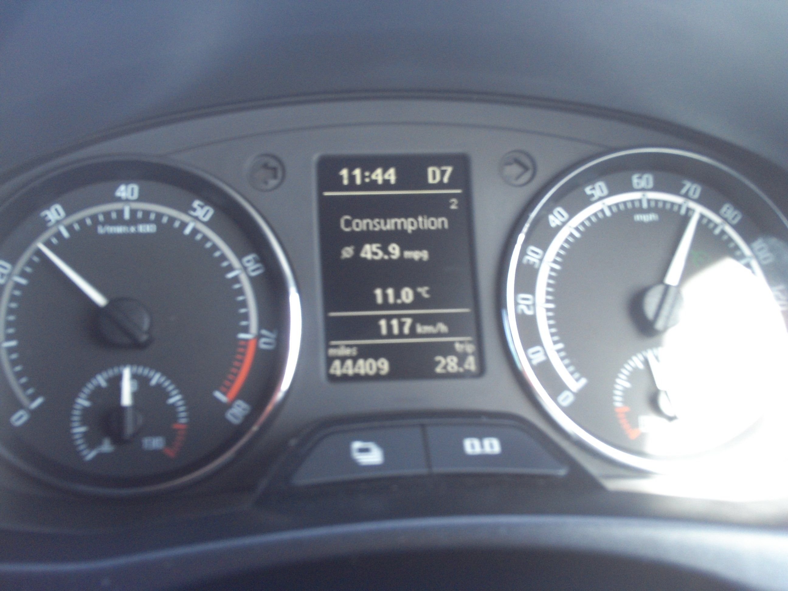

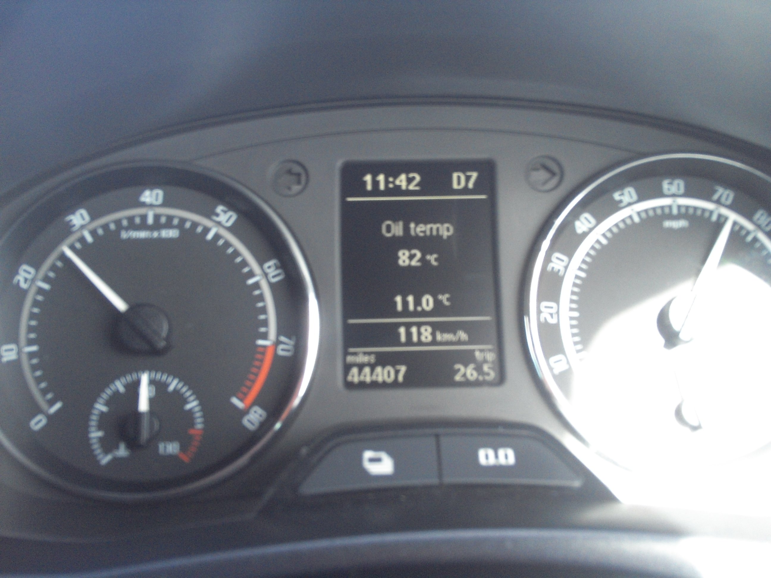

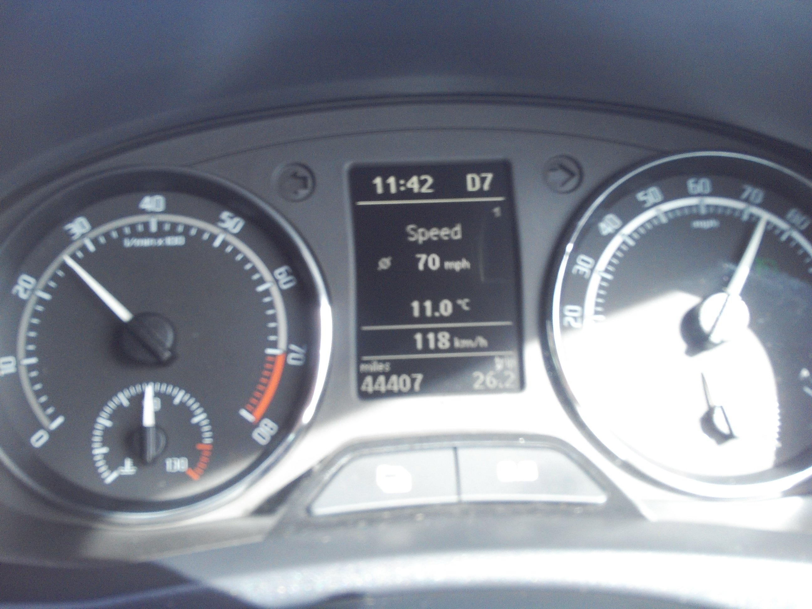

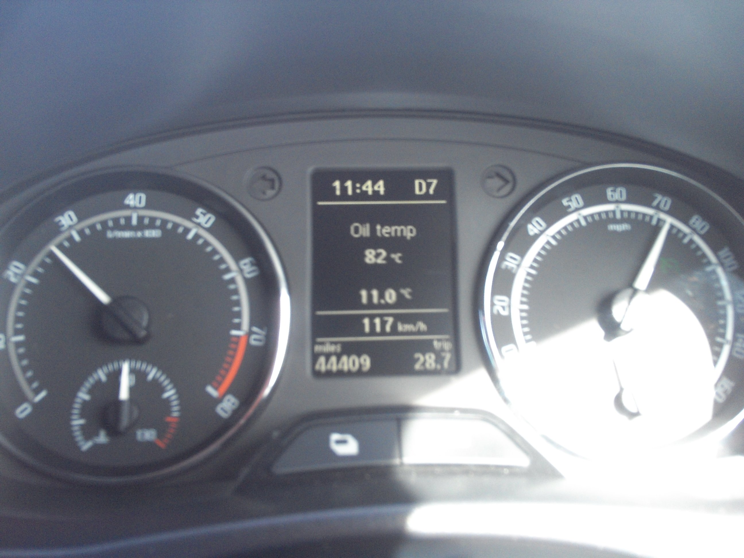

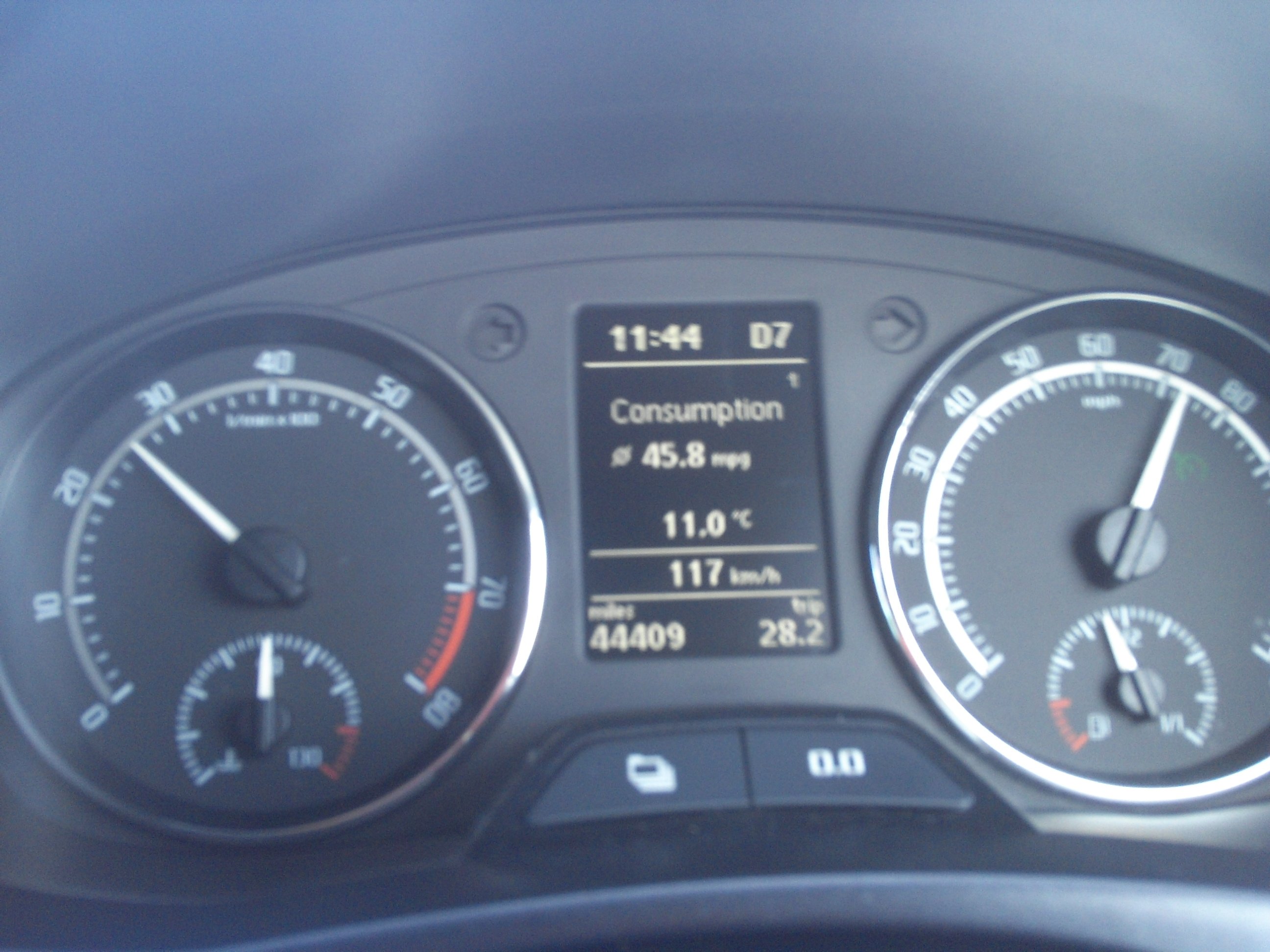

@Sittingbull 37-38 mpg is good
i get 31 on the motorways i have no idea why im only getting 23-24 mpg driving like an oap ?
Driving me mad
Something pretty wrong if you are doing 70 mph or so with a not very heavy load and the car is at about 2,400-2,600 rpm and you are not getting in the 40's MPG with Super Unleaded.
Are you zeroing the Maxi Dot before setting off on trips.
Around town on short cold starts 23-24 can be right. Go longer than 10 miles and it is poor though.
This type of figure at 70 mph or so with a standard CAVE.
Car not even up to efficient oil temp.

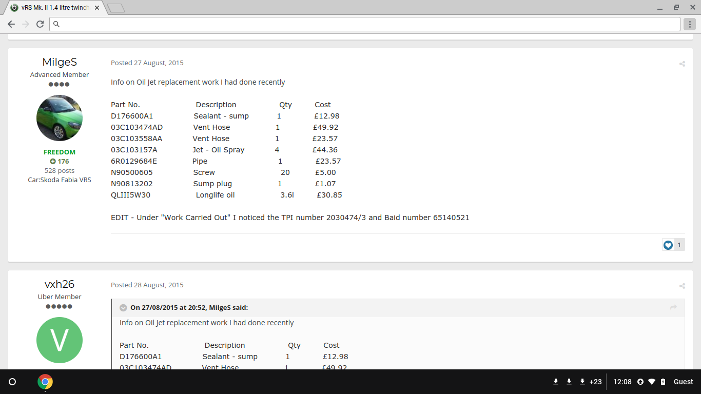

This is on Page 1 of this thread if anyone is looking at getting the Oil Spray Jet update.
This was on a New CTHE engine, one of the first ones.
When I visited the garage my seller recommended there investigation showed there was a problem with the pipe either entering or exiting the supercharger, they weren’t specific,  it’s booked in again with them on Wednesday to get it rectified. The guy said it could possibly have a bearing on the oil consumption.
Judging by the invoice for the oil spray jet work parts excluding new oil comes in at about £200, I’m guessing the job is just done by dropping the sump which doesn’t seem too drastic or time consuming, possibly something the mechanic I use for all my servicing to tackle fairly easily. I’m going to look at other avenues first with regard to the oil consumption, I’m not going to 5w40 oil yet as I’ve got a stock of C3 in already, I’m going to try something which I used years ago to combat oil consumption successfully, STP Oil Treatment, in this case  STP Synthetic Oil Treatment, I’ve ordered some and it should be here in the next few days, the 300ml bottle is said to be enough to treat 4.8litres so I’ll only need to add 225mls to the engine, the rest I can blend with 1.2litres of top up oil.
Are the part numbers the same for the CAVE engine ?
To my knowledge yes.
There is an Oil Squirter thread if you check, maybe more than one.
Best not just google just 'squirters' though'.
I would save your money and give the Oil Squirters a miss.
Edited by Skoffski
