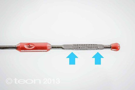

The opening post on this thread says that "The oil capacity is exactly 3.6 litres, you should NEVER overfill.".
I seem to recall reading somewhere here that people do actually put in 3.9 litres of oil.
Why is this not a problem and what exactly would be the result of overfilling the oil?
Just curious . . .
I put in 3.9 or even 4 litres in my cars or those belonging to others that i discussed with the oil quantity and the 'possible' issues with Twinchargers and that understood why, and were happy to try that amount of oil from a Oil & Filter change,
Reason i started was after talking with a Master Tech then others that were doing the same from the experience of 3.6 litres really being a bit low and going low to soon with oil users.
3.9 or 4 litres shows the correct reading on the dipstick @ Normal Operating temperature.
You can read the level with Stone Cold oil and then after starting and stopping the engine, and then after a run.
There were plenty techs servicing and putting in 3.6 litres, then topping up more and actually using 4 litres.
Some were over filling and putting in 4.2 litres.
I am not suggesting anyone does put in 4 litres, just saying IME it was and is not a problem.
The problem is more 5w 30 Full Synthetic Long Life oil IMO.   & 3.6 litres and 1.3 litres lower and still no Low Oil Warning Light or message given.
