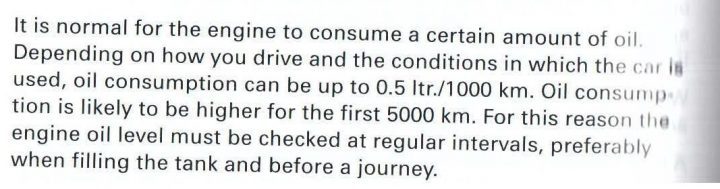

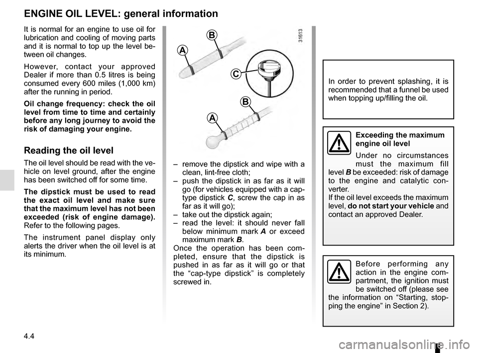

Incidentally, there is no such thing as "marginal", it is either inside or outside spec. - ½ litre in 1,000 Km
May use 0.5 litres in 1,000 km is not 'the spec' though, 'May be as much as'   ('Can be as much as after running in' *Renault*)
which is why others had engines replaced when they used 0.3 litres in 1,000 km.
A figure published for, 3,4,5,6,8,12 cylinder petrol or diesel engines from 44kw up and for years now.
As to the test that had the vehicle do what ever distance the test was, which seldom was 621 miles or 1,242 miles.
So the test not really fit for purpose.  One where the testing results were very questionable especially where dealerships employees seemed to have difficulty carrying out accurate tests, or even doing basic maths.
So as to marginal, there is such a thing, and also VW Group have done plenty warrant replacement of twincharger engines in the UK & Rest of World
regardless of 'May use 0.5 litres in 1,000km and the oil used being less than that.

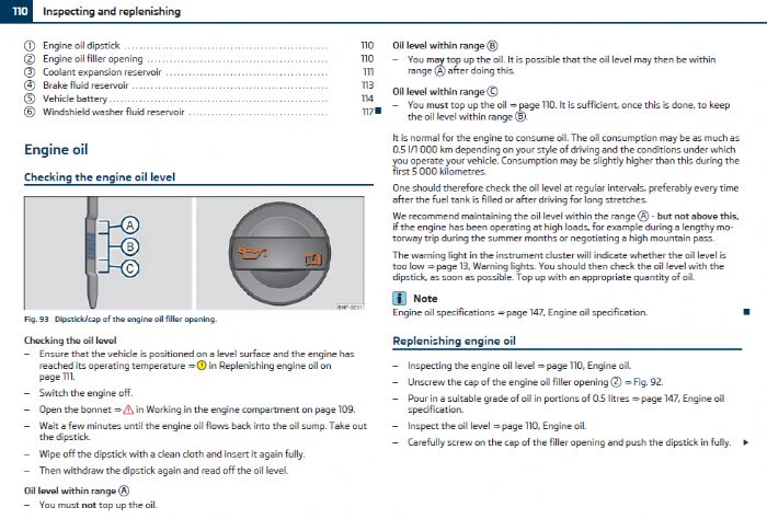

How much oil is there between top and bottom of hatched area on dipstick... I’ve had to stick half a litre in a couple of times in the last few months. Will check mileage on this next 1/2 litre. It’s a 2013 CTHE and brought it with a 5 yr from new manufacturer warrantee on so just checking if it’s worth getting it in to skoda.. they have said at last service that if I’m concerned to bring it in but I’ll have to pay if it’s not using more than manufacturer recommendation
Top of the Crosshatch to the bottom orange ball still with oil on it when oil / engine cold is over about 1.5 litres.
As to crosshatch bottom to top best check yourself and then you will know the answer because it is not 1 litre on the 3.6 litre capacity engine.
About .75 litres maybe.
