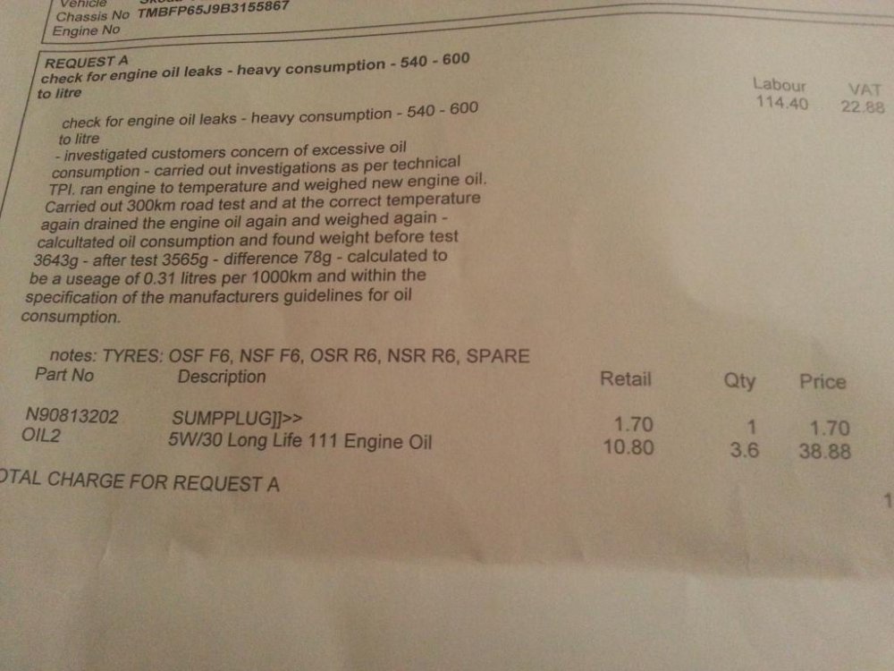

On 10/20/2017 at 23:23, AwaoffSki said:
The official test should have test results and weights and measures.
Something like this, but without the obvious error.  This member had a new engine fitted once Skoda reviewed the errors that were shown by this invoice and correct testing carried out.
then you can buy a Skoda Warranty, maybe about £275 for 12 months,  but first you maybe need a New Engine,
so best get the 'Test Results'.
1 litre Engine oil, 857 gram, so see the Oil in and then weight, and oil out weight, and the calculations.

Hi and thanks for your many helpful posts on this topic Awaoffski .
I have had a consumption test done on mine that say is 'normal' but obviously not in the real world.
Can you tell me where the error appears in the above invoice?  They have not given me any written documentation about the test and say I would have to pay for this paperwork (dealership policy - queried with Skoda UK who couldn't do anything).
Maybe if I pay for the paperwork it would be worthwhile if it reveals another error as above?
Thanks for any help you may give :)

No need to pay for the paperwork.  If someone does an Oil Consumption test they need to do a report and show the result.
Error.
1 litre of engine oil does not weigh 1,000 grams, not at 0*oC or even at 90*oC.
It weighs 857 grams.  so if the Technician fits a New Oil filter and 3.6 litres or even 3.9 litres of oil, runs it to operating temp,
drains or sucks out the oil and weighs it it is not 3,600 Grams. or something odd has happened.
Same when after 300 km,. or 1,000 km,  Engine Oil does not weigh 1,000 grams a litre.
No DATA Protection on a Test Result.
If the technician did the job no need to be shy, unless their maths is suspect, or they never followed the test procedures.
This was the old system.
Better than the rubbish Skoda went over too.
Even putting in the correct oil, sealing the Filler & the Dipstick and driving for 2 tank full of petrol or untill the Low Oil / Oil Pressure Warning comes on, recovering the car, then dropping and checking the oil is a better set up.
Any Dealership saying 'No issues' can surely allow that.,...

11 hours ago, Paul5000 said:
Sittingbull - Before they did the O.C test they topped oil up to the perfect level and got me to drive normally and see when the oil light came back on.  The light came back on after 630 miles!  I think the oil tank holds 3.6 litres?   They agreed that this seemed high and hence agreed to the O.C test.  So as I've pointed out the 2 results are not even close.
The fact that in your case they went straight for engine replacement was a good result for you.  My 'case manager' has already stated that a previous customer with a similar problem got no positive result from all this but said that they will 'do their best for me'.
I've already stated to them that I'm not an idiot and that I know there are plenty of other cases of this fault out there (on this fine forum no less!) and that they are risking my future potential custom as a Skoda purchaser.  Our 'dance' will continue after the Easter break....
Whether there are other avenues of compensation such as a Skoda enhanced trade in value of the problem car I doubt so it looks like repair, modification or replacement will be my targets.
Your consumption levels in real world every day use almost mirrors where we were prior to the engine change, possibly even slightly worse. I think we were a litre every 600 odd miles, you might be 1.2 litres per 600 miles or so as I think it's just over 1 .2 litres from orange ball marker on dipstick to light coming on. There's no consistency between the 2 tests, maybe a reason why they've been reluctant to share the test results with you.
Your case manager is going down the classic straightest of straight bat lines with you, thankfully you've stuck to your guns and let them know you're not going away. You do have the extended warranty so hopefully that comes into play sooner rather than later, this is an issue that is known to them given the number of cars that have been worked on whether breather mods, squirter jets or indeed engine changes. Some with engine changes went on to have another engine change. When you are "dancing" with them, be sure to lead and trod on their toes occasionally.
If the case manager eventually says there's nothing they can do, ask for the case to be escalated to Executive Office level ie make Rod McLeod aware so that he puts one of his team onto it. Hang in there, because one with the engine the way it should be is very much worth the wait.
Good luck and keep us all posted.
