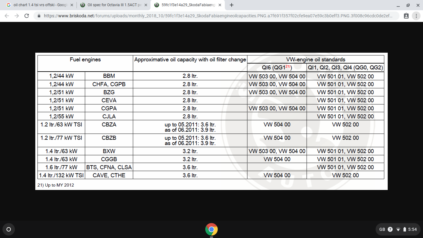

Edited by Skoffski
Finally got round to booking my VRS in for a Cruise Control retrofit next Thursday, I’m taking it to Awesome Gti in Manchester, be quite interesting to see what other stuff they do while I’m there.
Also I saw a comment on a thread on the Seat user forum which advised not topping up the oil on a twincharger higher than the top of the hatched area on the dipstick, they reckon  doing that increases the oil consumption, thoughts ?
Edited by Fitzwilliam
On 17/05/2019 at 16:30, Fitzwilliam said:
 ~ ~ ~ I saw a comment on a thread on the Seat user forum which advised not topping up the oil on a twincharger higher than the top of the hatched area on the dipstick, they reckon doing that increases the oil consumption, thoughts ?
I have certainly read that one should never put in more than 3.6 litres of oil (presumably up to the top of the hatched area?) but I have also seen comments that it is safe to put in 3.9 Litres - WHAT?
I have never seen or read anything to explain why overfilling might be harmful - however - personally I would never fill to above the top of the hatched area.  There appear to be endless "tales" about the VW Twincharger engine - there probably are on other vehicles as well - I can't say that I have conducted any sort of a study of "popular wisdom from the armchair" ;)
Edited by SeaGoat

Personally I was always told that having the oil level too high was damaging to the catalytic converter, I don’t honestly know what level on the dipstick equates to exactly 3.6 litres, the information in the handbook is slightly vague on this point, stating you may add oil in the hatched area and not to add oil if above the hatched area, why  couldn’t they just have a minimum and maximum mark like most manufacturers do. Since I’ve had my VRS I’ve tried to keep the level midway up the section above the hatched area. I know my car is a fairly heavy oil user but it’s manageable particularly as I don’t do a lot of miles, once my stock of 5w30 E3 is used up I’ll try 5w40 which has been suggested by others.
I’m personally not a hard driver (being 66 years old) and the VRS is a car that doesn’t need to be caned, it’s attraction for me is that it has 2 characters, driven gently it’s so quiet and refined, although the wide low profiles certainly let you know how good or bad the road surface is, it’s certainly more rewarding to drive gently than say a Mk 1 or Mk 2 Civic Type R which just wants to fly all the time, I’d personally like the throttle to be a bit more sensitive, I find it a bit heavy and I get an aching right foot at motorway speeds, hence my having Cruise Control fitted in the coming week.
I put in 3.9 or even 4 liters of 5w 40 FS / VW502 oil.
As many Dealership Techs also did.
This has the Oil when checked 'at normal operating temp' at the top of the cross hatch area.
When cold on the flat above the cross hatch area.
Maybe if VW Group had officially change the Oil Capacity and also not had such a crap dip stick there would have been less Twinccharger failures from 2009.
The 1.2 TSI capacity changed.
Some techs wrongly put 4.2 liters in Twincharger engines, that is too much oil.  3.9 is actually correct IMO. & IME.
Bottom Official Oil Consumption test and the tech has the wrong weight for oil....
