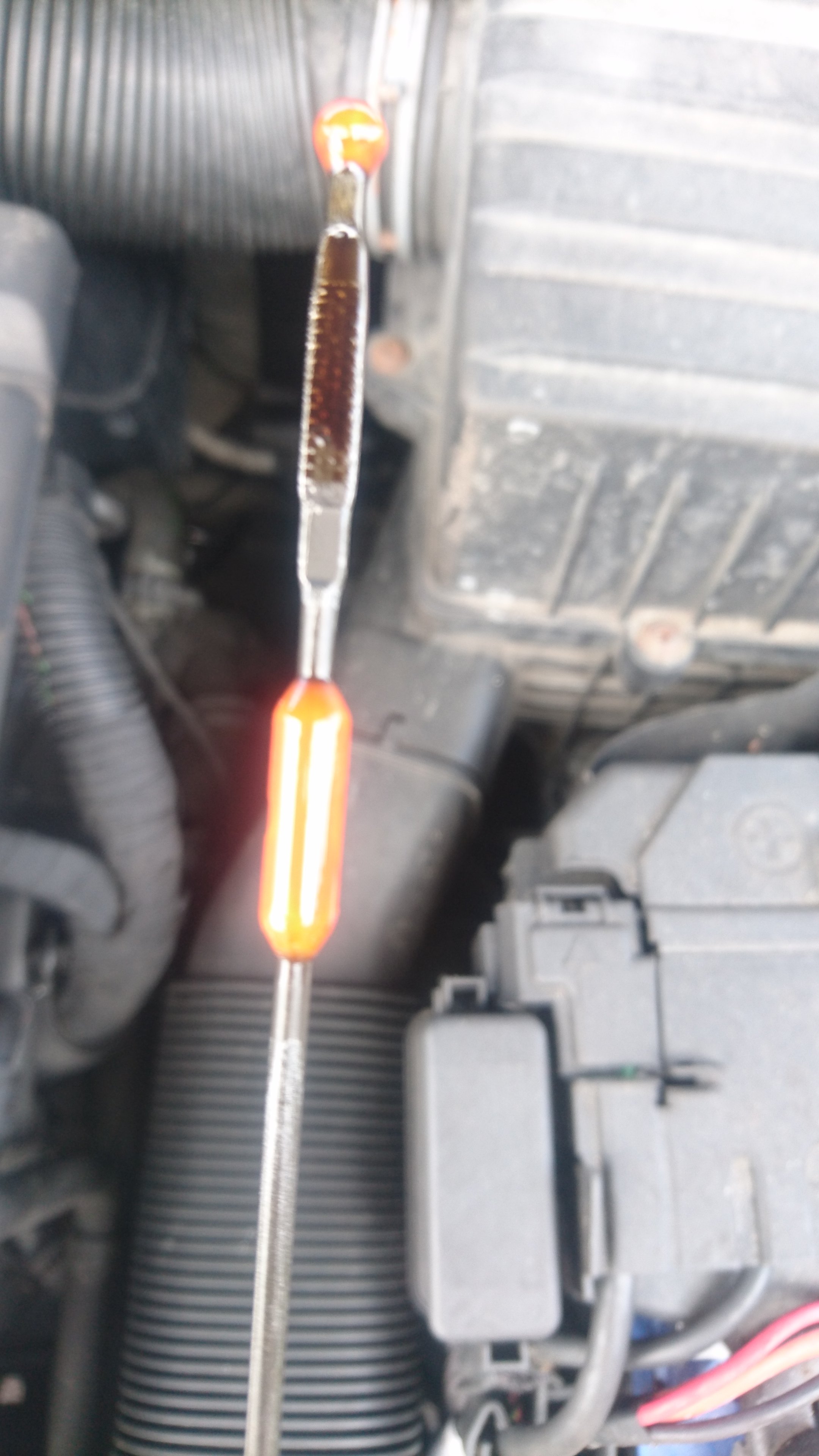

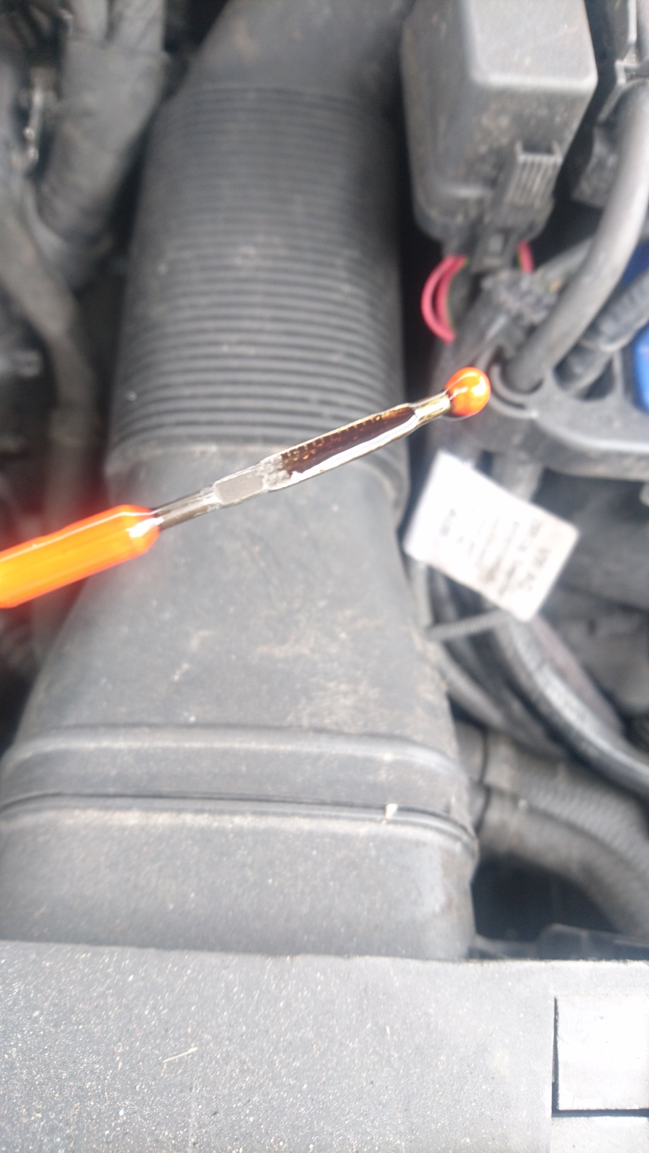

Checked my oil today. Covered 1679 miles since I got the car. Doesn't look like it used a massive amount.

Is that a Hot Dip?
 Where is it with a cold dip, just above the cross hatch?
I done one cold. And one hot. Here's the other
Both look similar to me. Got the oil temp up to 90, then i let car sit for five mins then checked it warm
Hot has about 0.5 litres less in the sump.
If not using any oil then good, but top of crosshatch hot after stopping 4 minutes or so is good, and cold that would be just up the flat part above the cross hatch normally.
